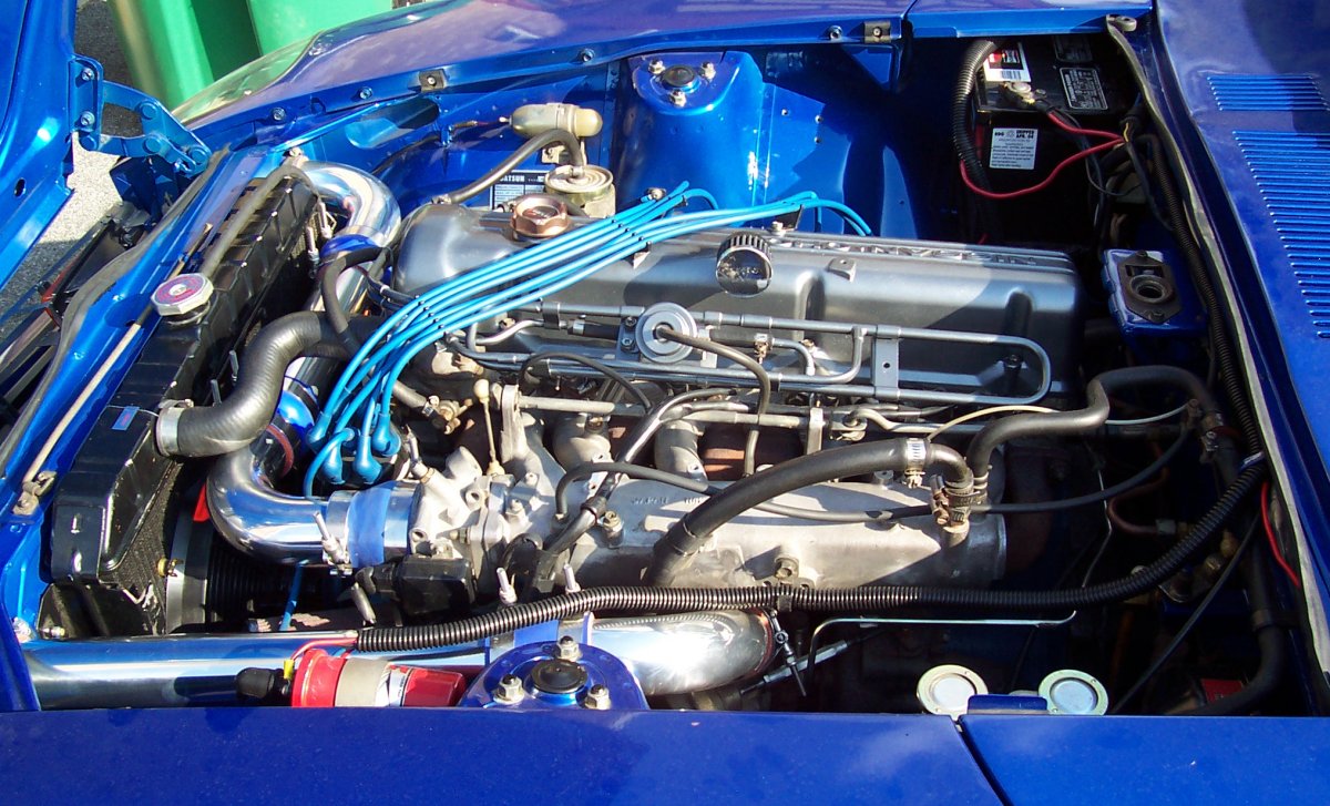

Like hls30 said, there are kits out there. But the cheapest and easiest way would be to get a 280ZX turbo engine (and upgrade to the 5-speed) setup and drop it in. I did that to my early 260Z and it wasn't that hard. Here's a pic...
Chuck
Okay, that makes sense. I was just unsure of the option of being able to strap on a turbo with limited fabrication or if it was more cost effective to drop in the 280zx engine or just buy the engine from sites online that come with everything needed in them to drop into the engine (sr20 setups).
I was going more for the "can I keep the stock engine in it with a turbo" vs drop a whole different engine into the bay. If the cost is better to put a new engine in I will. The only thing I won't do it drop a 350 in.
