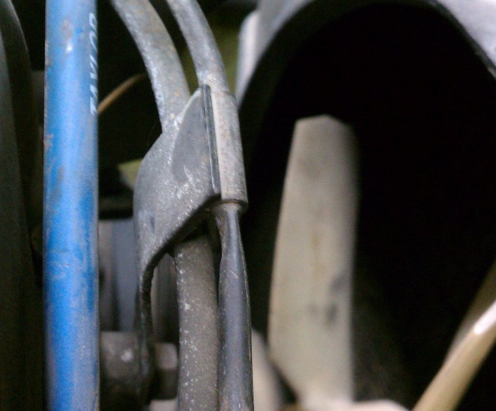

I just got my '72 240z running again, for about 5 seconds. I installed a Carter P60504 electric fuel pump with an advertised shut off of 4psi. From what I have read the SU's do not like anymore than 3.5psi. Upon turning the key and letting the system prime fuel started pouring out of the air cleaner/intake side of the carbs at the bottom of the large opening. I unplugged the fuel pump, waited a minute, turned the key, and the car would run until it emptied the fuel in the carbs. So my question is, if the floats and needles are working properly would the keep fuel from filling up the carbs and leaking out? If my floats and needles are fine then I am pushing too much pressure in to the carbs and bypassing the needle and seat shutoff int he float chamber? I have not opened the float chambers yet as I wanted to have some float gaskets on hand before doing so. I had also posted up in the Engine section about my return fuel line. It is crimped but I can still blow air through it. Below is a picture. Should I consider finding a new fuel rail?
Yes , the fuel rail return side is a metered orifice, I would replace it.

Another fuel rail would be the way to go, but before you do that,
if you squeeze the return line the other way you might be able to open the orifice again. It may give an indication if that is your problem,
