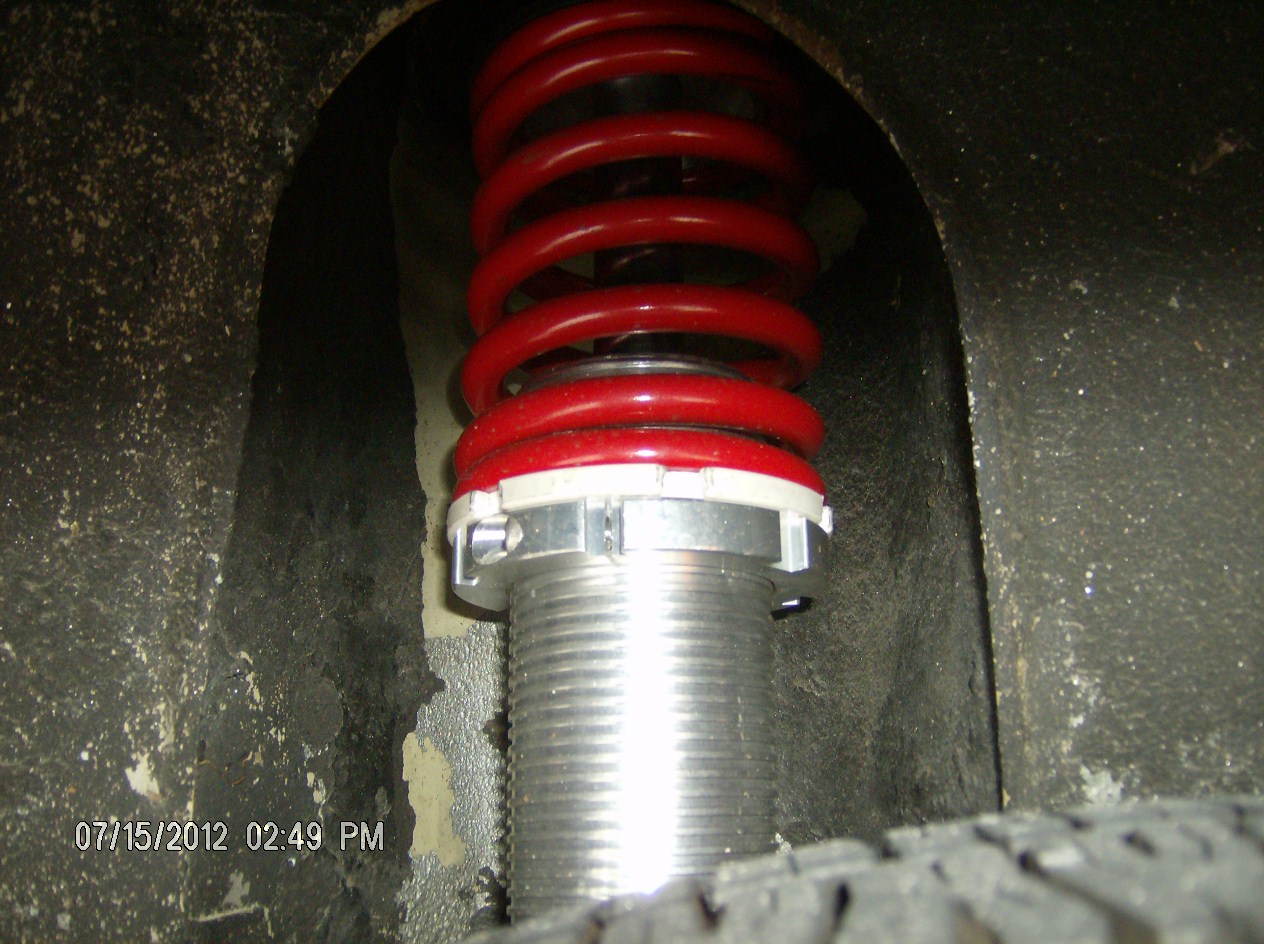

front pic
rear pic

I believe the spring rates are published when you buy them, but possibly in a metric format. One thing I noticed in the pictures above regarding the rear spring set up. If this picture was taken with the tire in full droop, I'd say there is a good chance of coil bind. If you are in a corner or just accelerating hard and the coils all touch each other, essentially you have gone to what I call "infinity" spring rate. This will cause massive oversteer or lack of grip.
