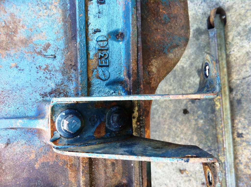

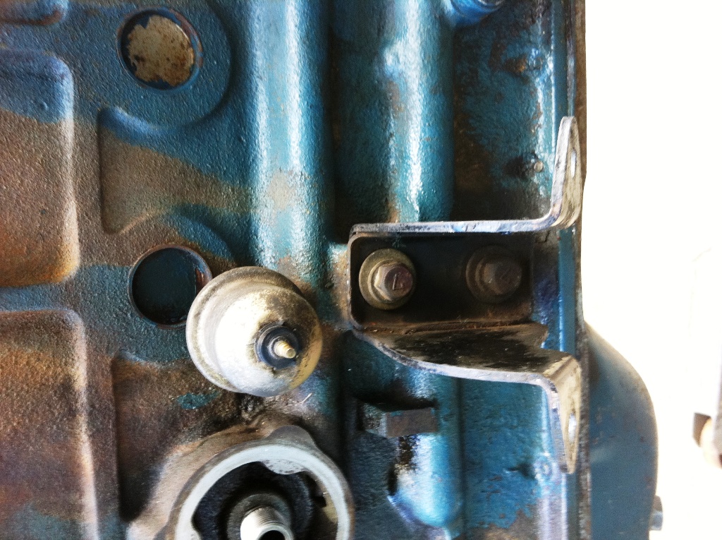

I have removed my engine for a stock rebuild on my 1970 240Z. The guys at nissan were in a hurry and sprayed the 'turquoise' (Nissan blue-green) engine block colour on all sorts of things. However the the engine brackets that are bolted to the block are two different colours- see pics. The right one is black and the left one is blue.
What was meant to be the colour of these brackets on this car?

[ATTACH=CONFIG]54578[/ATTACH][ATTACH=CONFIG]54579[/ATTACH]
I went through all this on my re-fresh. You can check it out on this thread. It will discuss most of the items you will encounter. Very interesting history.

Thanks guys. I guess they should be black but in the end I kept them as per how they had it from the factory on this car.
I also notice that the engine images above are not as per my original motor. My crank pulley ( Harmonic balancer) is Nissan blue-green. Alternator pulley is black connected to cad (yellow zinc) plated fan.
