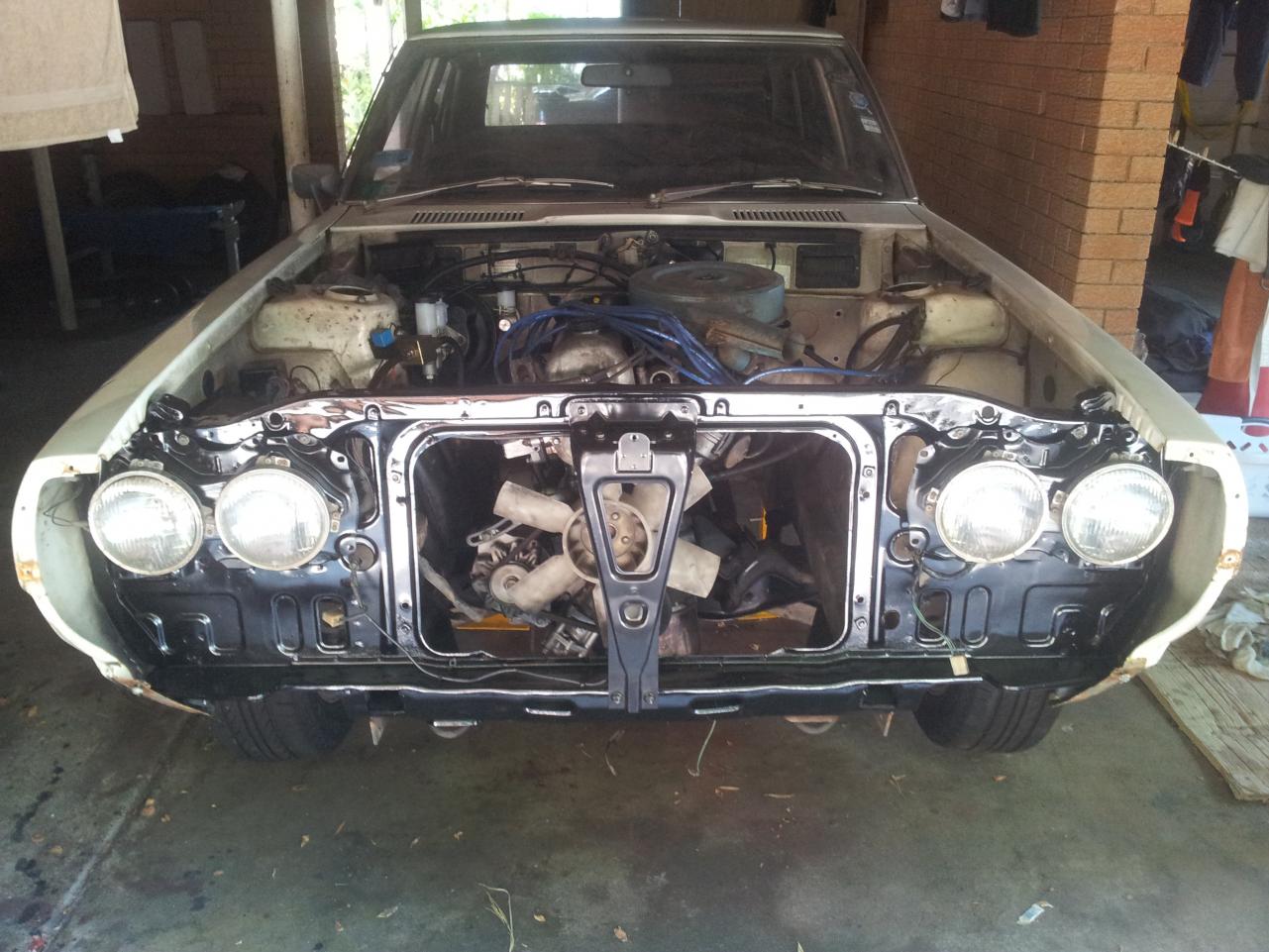

January 17, 201312 yr Author comment_412155 So I've finally found time and a spare set of hands to get into it again. I've painted my headlight buckets, painted my rad support (front), stripping and repairing the bottom bumper panel, painted the insides of my chrome bars, reinstalled my headlights, installed gearbox, hooked up speedo cable, gearbox crossmember, diff is back in, cv's are in. Electric fuel system properly set up My rear garnish and oil drip tray came back from the powdercoaters, so I'll have to install them. Also been busy cleaning up all my spare badges, grilles etc. Is a rear "skyline" garnish badge with no pins worth $115 posted? Anyone know how to rewind a speedo? I got a spare I wanna put in when I put in a new motor. She'll also be wearing new shoes soon, 14x8 and 14x9 globe lines with a bit more low and stiff. Pics tomorrow. Link to comment https://www.classiczcars.com/forums/topic/43630-yonmeri-k/?&page=2#findComment-412155 Share on other sites More sharing options...

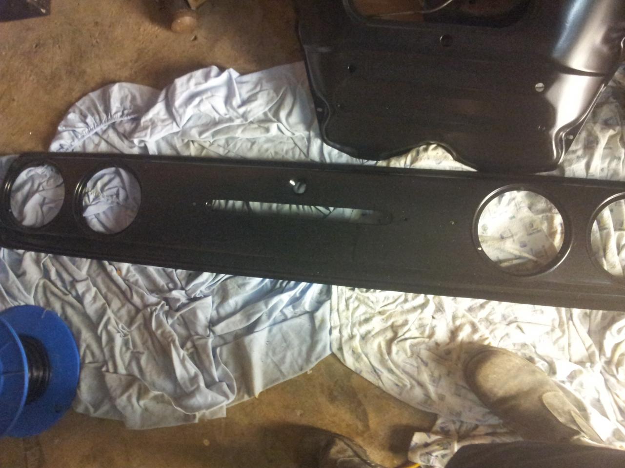

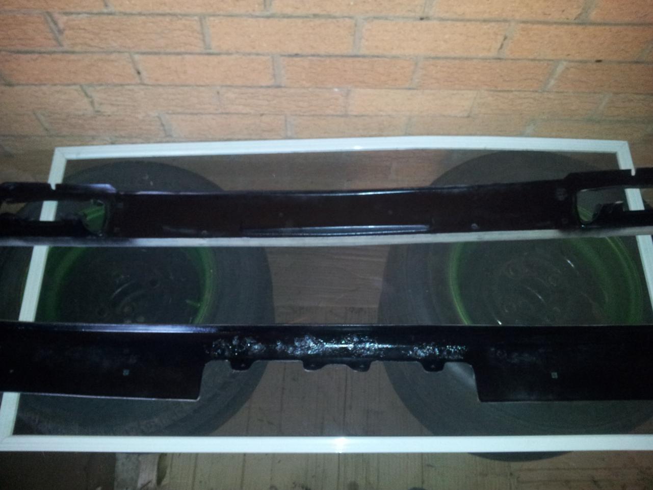

January 18, 201312 yr Author comment_412324 As promised here is an assortment of new pics. Btw, I'm only 23, so I'm still learning a lot about painting and stuff. (I know mechanical down pat ) Link to comment https://www.classiczcars.com/forums/topic/43630-yonmeri-k/?&page=2#findComment-412324 Share on other sites More sharing options...

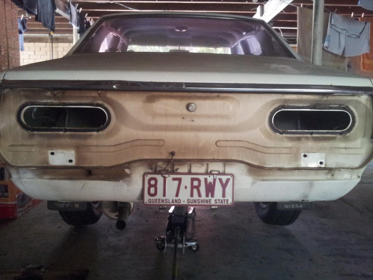

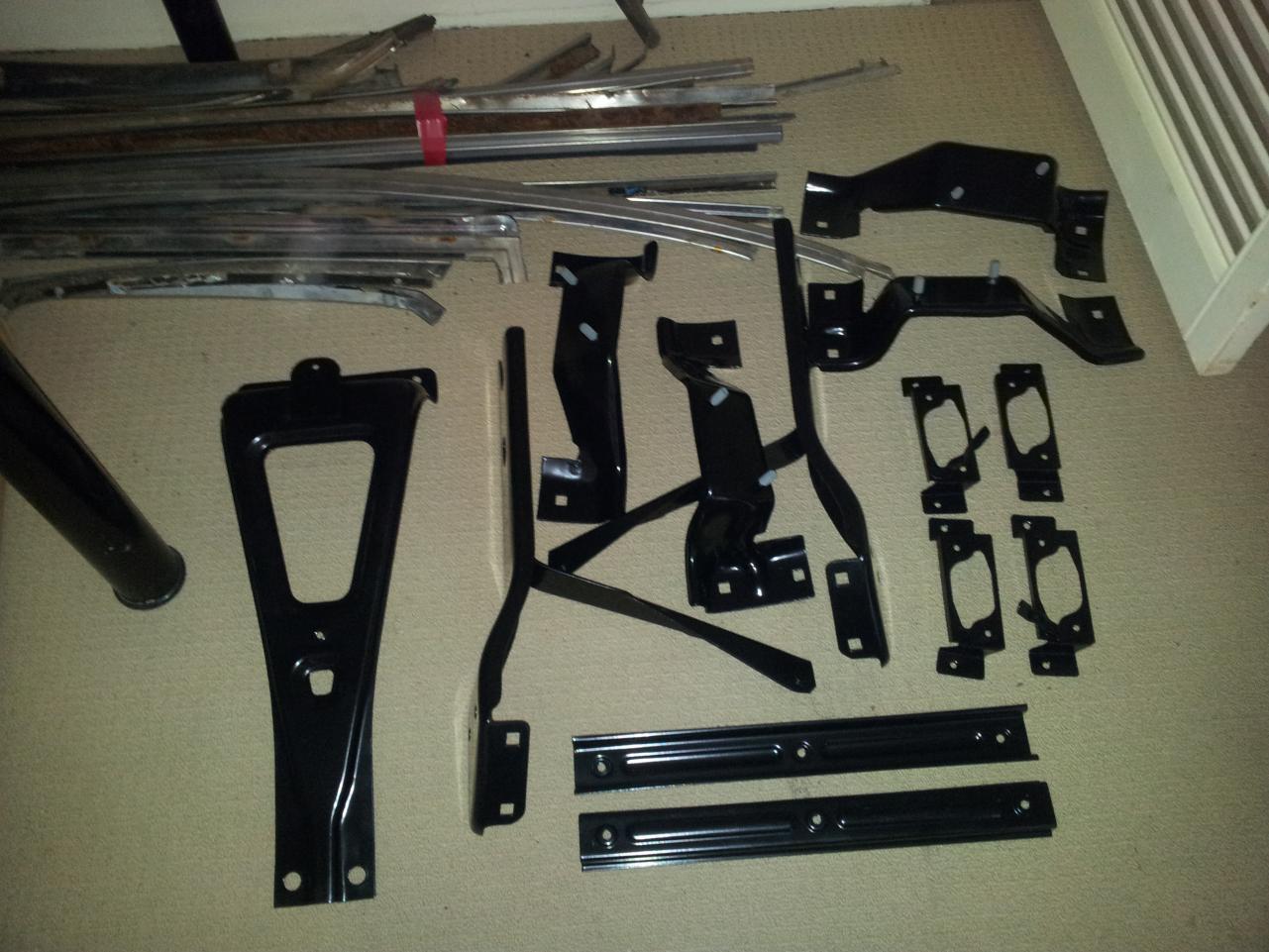

January 30, 201312 yr comment_413489 I recognise 90% of the parts in the following photo.. but what are the 2 strips on the bottom right? Link to comment https://www.classiczcars.com/forums/topic/43630-yonmeri-k/?&page=2#findComment-413489 Share on other sites More sharing options...
January 30, 201312 yr Author comment_413498 They hold the middle rear badge in place. Badge has 3 pins that bolt to that. Link to comment https://www.classiczcars.com/forums/topic/43630-yonmeri-k/?&page=2#findComment-413498 Share on other sites More sharing options...
