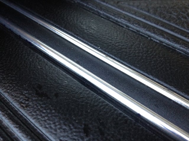

I'm looking for something the in the same design is possible, with the two chrome strip and black in the middle like these -

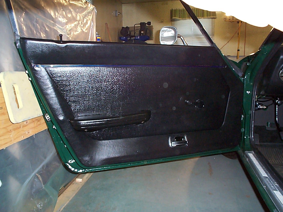

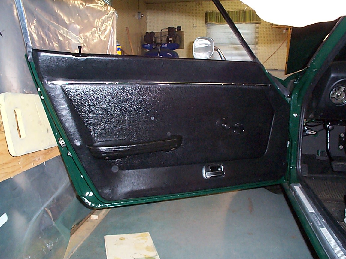

I remove the thin layer of chrome, mask off the blue area, scuff it, spray with 3M glue, apply a layer of mylar and cut off the excess.

Here is a picture of some original chrome work, it's approx 16mm in width.

I'm not sure that I understand what you're saying. You want to remove all the chrome so only the blue base layer is left. Scuff the blue with Scotchbrite and spray with a good 3M adhesive. Apply the Mylar to that and trim off the excess. Here's a panel (before and after) I did years ago. Sorry for the poor quality of the pics.
