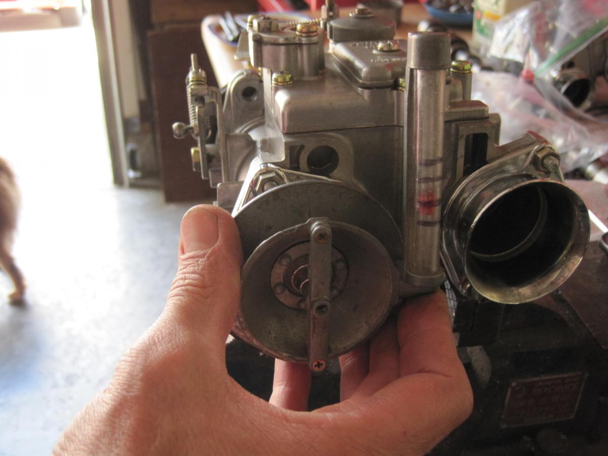

So my engines apart and I'm wanting to check the carbs over before putting them back on. Since I was having running issues with my engine I really wanted to eliminate the Mikunis as the source. Everything checked out on the carbs, but I was suspicious of throttle plate damage from slamming the throttle(maybe a few times:o)
Looking down the barrels with back lite I tried to eyeball the light making it through and see if the openings were the same. Checked for looseness in the throttle plates also. Some looked suspect, but still not sure how to measure the opening.

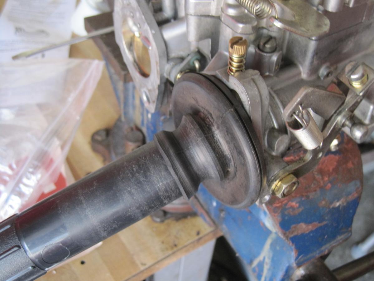

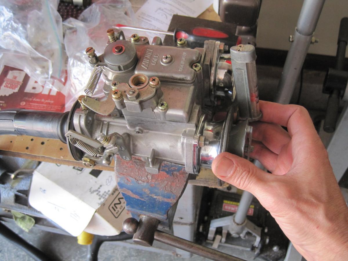

Then I had an idea(careful now), what I checked the air balance with the carb off the engine. If I had a consistant suction I could use my unisync to measure any differences. So I dragged out the Oreck( my wife got excited for a second), and I hooked it up to each carb and measured. If this is an accurate test, then my carbs were pretty spot on.
I plan on stteing all my idle screws using the vacuum. At least I will know they are all set equal. never did like using the feeler gauge

So I finished tweeking the carbs with the Oreck and quick put it back in the closet before she got ideas!
I would suggest a fresh bag in the cleaner before attempting this. I noticed that some of my readings were fluxuating as if the suction was varying. I pulled the bag to see it was very, very full. So I got a new bag and proceeded. I did find one carb that seem to have a tweeked throttle shaft. A few yanks on the opposite throttle plate nuts and she dialed in.

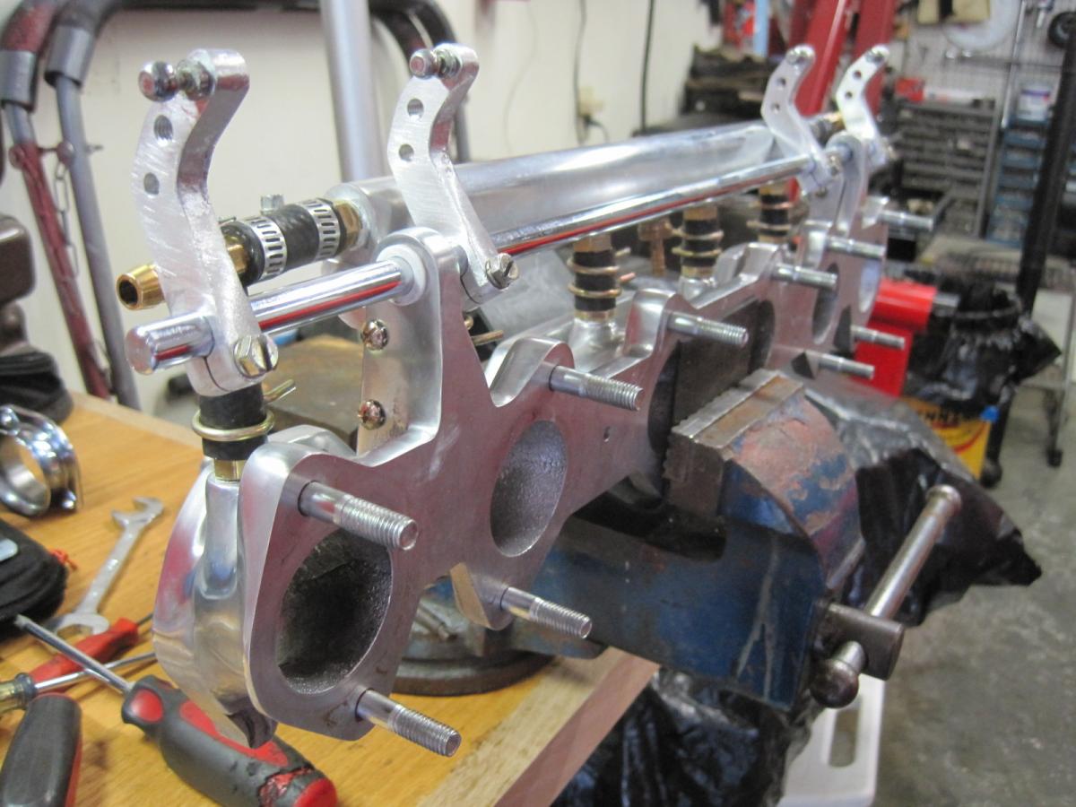

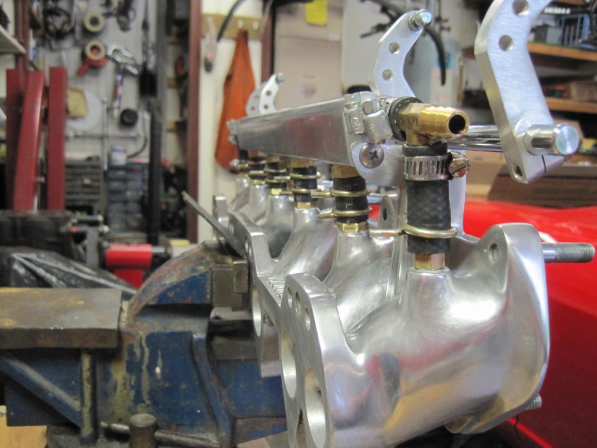

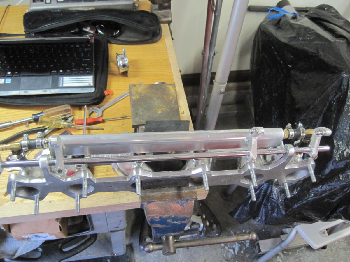

I moved on to slimming down my vacuum log. ive been trying to come up with a way to eliminate the hoses running over my carbs. I think this set-up will work and look much better.
