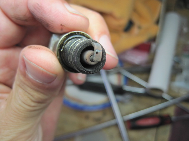

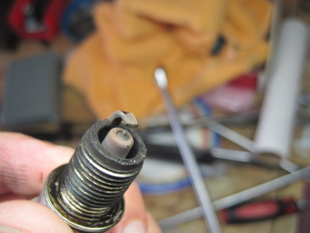

June 16, 201410 yr Author comment_449920 So I have the 70's pilots in there now and I watch my AFR's hang right in the beefy section on 13eens. At 75mph I was probably hanging around 13.2-13-5 at best. I was also watching my gas gauge thinking it was going to plumit at anytime. What happened was un eventful as the engine purred as good as it ever has and the gas gauge didn't move much different from before. I made a round trip to work which is 50 miles each way 80% highway. I tweeked the pilots to 1&3/4 turns out. That gives me 14.5-15 AFR idle. I'm telling ya-the engine/carbs love fuel. It just sounds better and runs better. Putting around town the engine responds quickly and decisively. Now look at my plugs. I have done nothing with these plugs since I installed my megasquirt. These plugs have seen everything from flooding carb to len mixtures. So after last nights run a pulled number 3. It is way better then I anticipated. The blackness at the top of the threads is dry soot and I always seem to have that. My tan line goes all the way down the plug! I might still turn in the pilots another 1/8. Link to comment https://www.classiczcars.com/forums/topic/42960-triple-mikuni-thread/?&page=7#findComment-449920 Share on other sites More sharing options...
