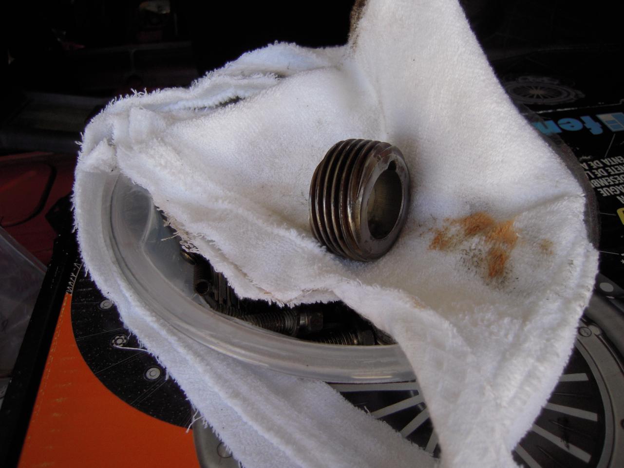

April 30, 201213 yr Author comment_388677 Well I believe this is odd. The drive gear for the speedometer on the transmission shaft is missing! Below is a drive gear from the first (wide ratio) 5-speed that was taken apart, so I have some idea what it looks like. I guess I am looking at this one coming apart too if the drive gears interchange from wide ratio to close ration 5-speeds. I could just spring for another 5-speed on Craigslist, but they are starting to take over the garage! Who would have thought it would be missing? Link to comment https://www.classiczcars.com/forums/topic/42803-transmission-swap-economics/?&page=3#findComment-388677 Share on other sites More sharing options...
May 26, 201213 yr Author comment_391176 To wrap this up on a good note, I took the close-ratio 5-speed (trans #2) to the shop recommended above who installed the missing speedo worm drive (donated by 5-speed #1). They also replaced the gaskets and seals along with a complete bearing set for $450. The car is now all assembled and I am really enjoying that 5th gear! At nearly 80 mph the engine is only turning about 3,000 rpm. All the gaskets and seals have held up fine including the new main seal and oil pan seal. No responses on Craigslist to the used 4-speed or 5-speed in parts. Any ideas for recycling these?Thanks for the help from everybody! Watch out for a multi-colored '72 on Highway 50! Link to comment https://www.classiczcars.com/forums/topic/42803-transmission-swap-economics/?&page=3#findComment-391176 Share on other sites More sharing options...
