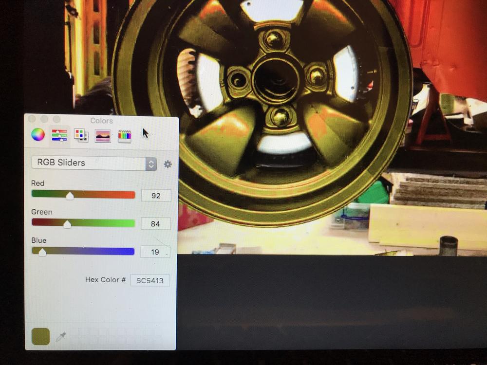

spent some time farting about deciding on wheel colour for its main wheels.
[IMG]
Thought I had decided, however still not sure.
[IMG]
[IMG]

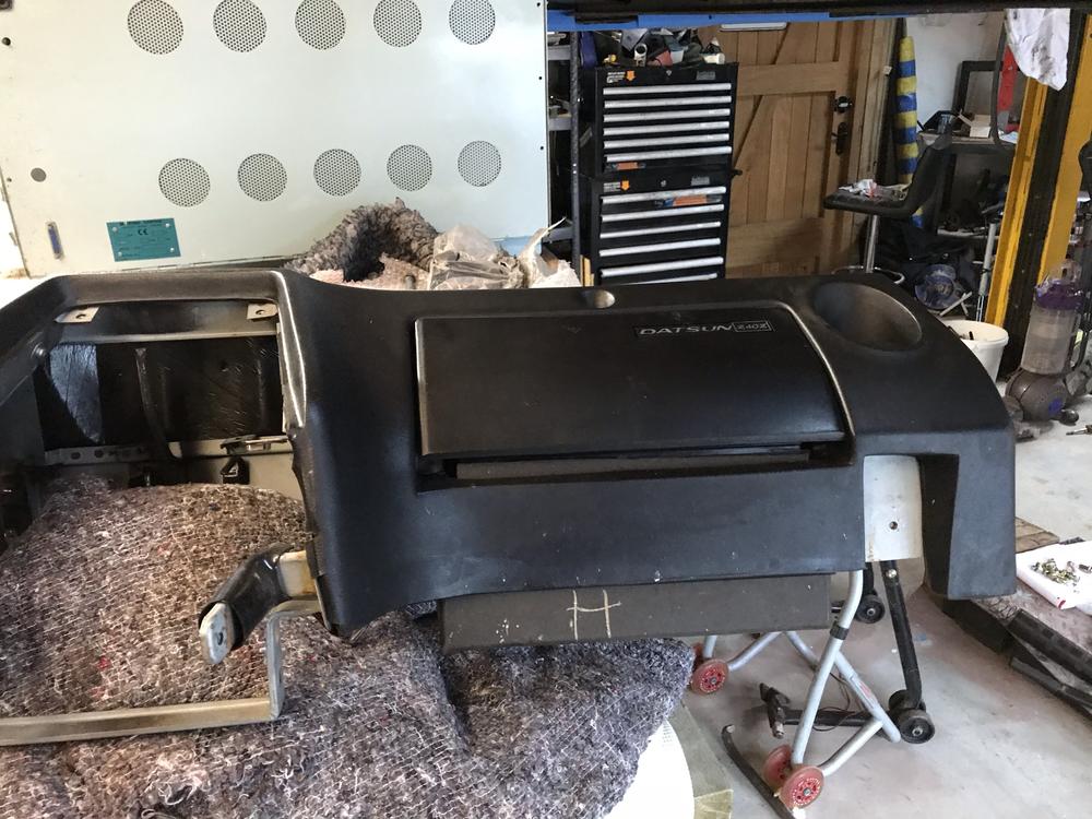

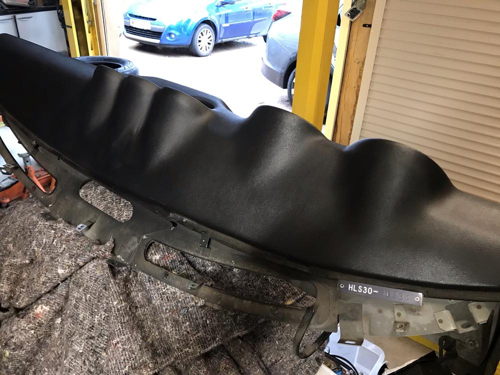

Got a decent LHD dash.

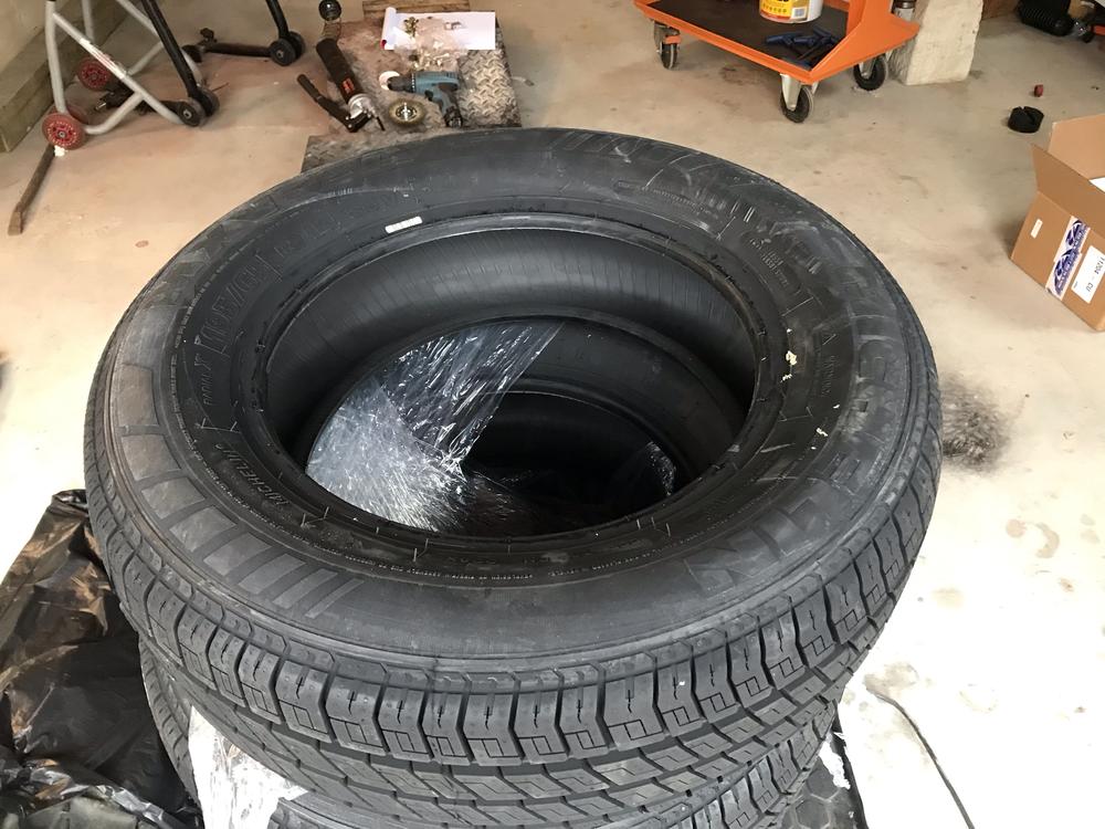

Got some tyres, managed to get them at a more sensible price than normal, i'm very pleased as they look so good, have amazing 'performance' reviews.
[IMG]
https://classic.michelin.com/en/Classic-Tyre-range/MXV3-A
195/65/14.
