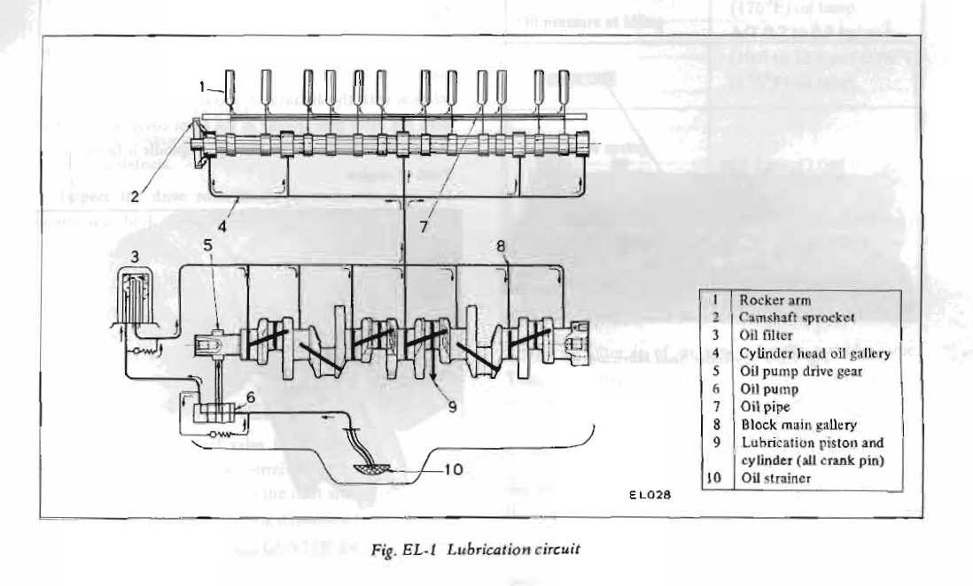

January 23, 201213 yr Author comment_378518 All the spark plug wires and boots are intact. I haven't check the plugs themselves, though, for cracks or breaks. Will do that tonight. I think they're okay, though.Here's a question: Is there any chance I had at least some oil pressure during my 3/4 mile drive? The corner of the battery punched a pea-sized gash in the oil filter; at that point, does all the oil just come straight out the filter? Is the pressure totally gone? I'm not totally familiar with the oil's path through the engine after it gets picked up in the sump and goes the through the pump. Link to comment https://www.classiczcars.com/forums/topic/42013-should-i-try-to-start-it-or-just-rebuild/#findComment-378518 Share on other sites More sharing options...
January 23, 201213 yr comment_378522 Pea-sized is pretty big. All oil passes through the filter unless enough pressure builds up to open the bypass valve. With a hole in the filter there's no pressure to push it through the bypass. How much oil did you put back in with the new filter? The odds are not in your favor. Link to comment https://www.classiczcars.com/forums/topic/42013-should-i-try-to-start-it-or-just-rebuild/#findComment-378522 Share on other sites More sharing options...
