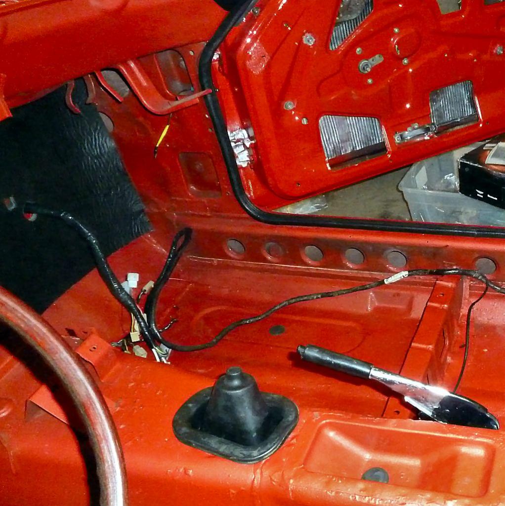

Getting the engine bay ready for soda blasting and am replacing the engine harness. Im having trouble finding where the harness connects to. I can't find it on interior side of the firewall. Is this something I have to take the dash out to get to? I found some connections below the dash, but this seems to be to a different harness. Thanks guys
Passenger Kick Panel is the MAIN connection point for (1) Engine Harness, (2) Dash Harness and (1) Rear Harness.
Look up high on the kick panel and you should see the entry point for the engine harness through the firewall.
No, you don't normally have to remove the dash.
