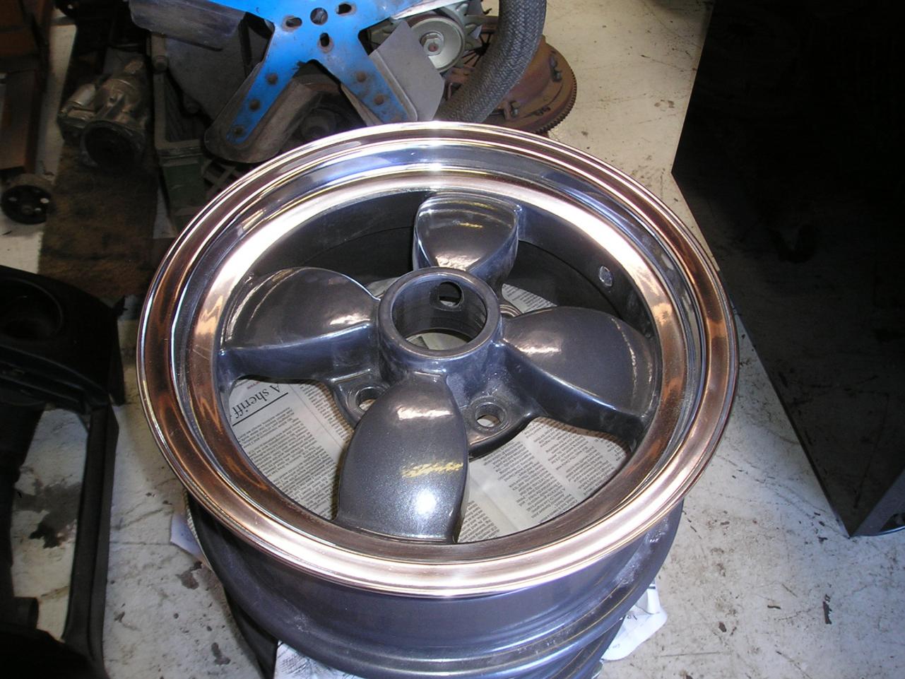

Desperately seeking tires! I have decided to stick with the original 14” AR Libre wheels on my 72 restoration project. That being said there are a limited number of good tire options. I posted this on my ongoing forum post with very little response. Arne did give me some good options.
Les has suggested the possibility of the Toyo DOT race tires which I like but I am a little worried that they will not fill the wheel wells thus looking a little odd. Any one used or seen these used on a stock suspension Z?
Arne suggested that I take a look at the Hoosier Speedsters 205/65-14. They will fit the 5.5” rim width and they are close to the original overall height but I am not sure I like the look of the tire; any other suggestions out there? Anyone seen or used the Hoosier Speedsters? Feedback would be greatly appreciated. Jerry Purcell

Jerry, all things being equal, I prefer Toyos over the Hoosiers as well. But I'm with you on the appearance and fender fill. I don't think Toyo has a 14" size that's going to approach stock diameter, and on a car at stock ride height, that's going to look goofy, IMO. That's why I suggested the Hoosiers, as they are the only high-performance rubber I know of that's close to stock height. The next best size would be something in a 195/65-14 (probably in something like Kumho, Falken, etc.), but those are going to be street performance tires, most of them all-seasons, so not in the same class as the Toyos or Hoosiers.
Jerry, Les showed me your wheels when I stopped by on Saturday. They look really sweet. I have not seen any of the tires your are asking about, but I do understand that you would not want a large gap in the wheel well.
