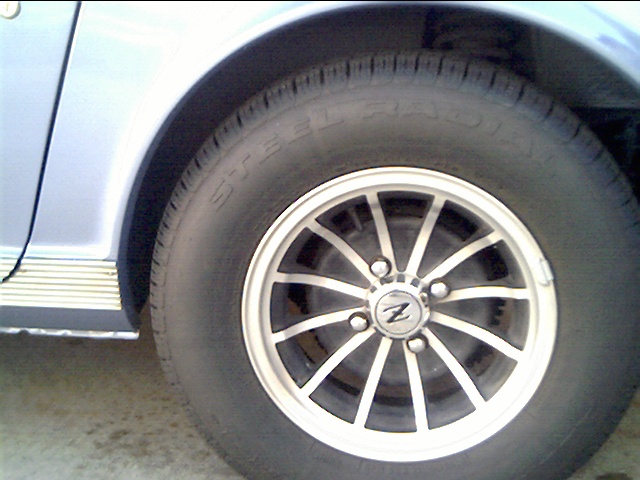

Hi!
I have these on all four and I really want to hang on to them. I believe they came with the car but I'm not sure and the PO wasnt either. First does any one know if these were dealer installed? and Second: Should I paint these the same color as the body or should i stay black. Also, where could i go to have these polished up? We have some wheel and tire places but would a machine shop be better? I'd appreciate any and all suggestions, comments

As far as I know, all the "mags" and "rims" that were put on the Z's in the 70's were Dealer Options. Although there are many wheels that are identified as being OEM, not until the ZX's did the Z's have wheels other than the stamped steel wheels.
I have a set of wheels that are very similar to the ones you pictured, but mine have a flat center where your spokes go all the way to the hub. Even with the addition of the Z hub from a later Z, they're still Aftermarket Wheels.
Alan may know different, and I'd trust his knowledge over my vague recollection.

Hi EScanlon! Thanks for the info. I think I will just polish them up with a polishing kit and use some elbow grease. They dont look too oxidized to me and I dont believe they have any kind of coat on them.
You said you used some gold Rustoleum. I wonder if they make my color. It's #510 Sky Blue Metallic. I know it was painted at Maaco (ack!, i know) by the PO so I wonder if they would sell me a batch of that if i go down there and ask. Or i will try to find it in rustoleum. thanks, Nick

Beandip: I think that's how I will do mine. I'll need to polish them up real good first (they aren't that bad now). I think i will mask them off and then paint them black. I was going to use the metallic blue color to match the body but (A) I think it'll be too hard and expensive to match up that color and (B) I think the black won't show the dirt and grime so much as the metallic blue will. Beandip, what kind of spray paint did you use? I saw Auto Zone has some wheel spray paint. I think a nice metallic black will look great!

Yes all factory wheels were steel with hubcaps.
All Mags were dealer options.
The 260z was the first Z to get factory alloys I think. You know the ones. I see them on every 260z 2+2 on the road.
