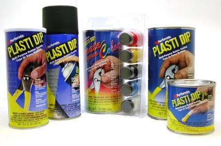

Plasti Dip offers a rattle can, available in clear. Of course, if the finish of the scuff plate needs to be covered over (by a bed liner coating) vinyl spray may not be what you need.
