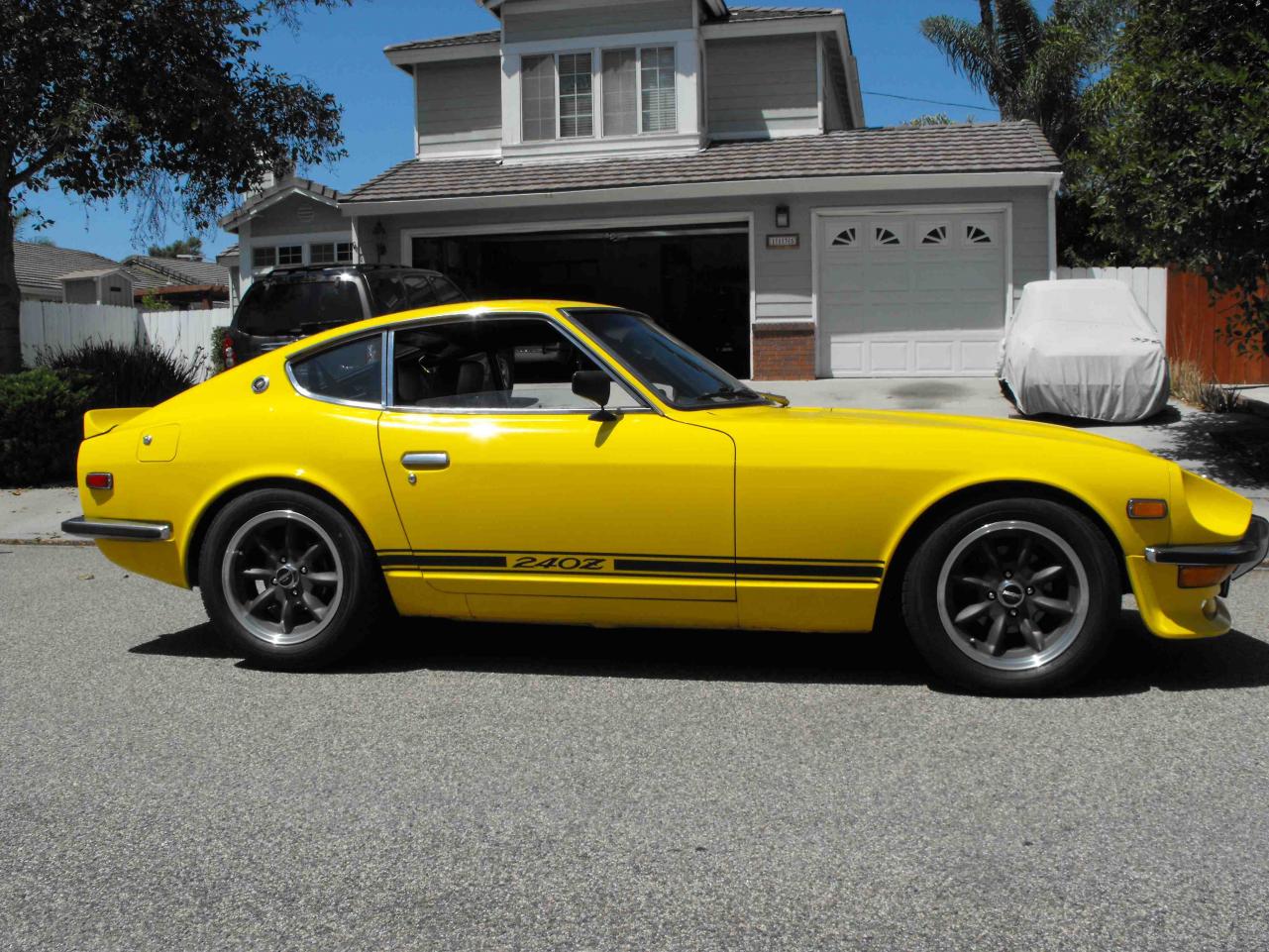

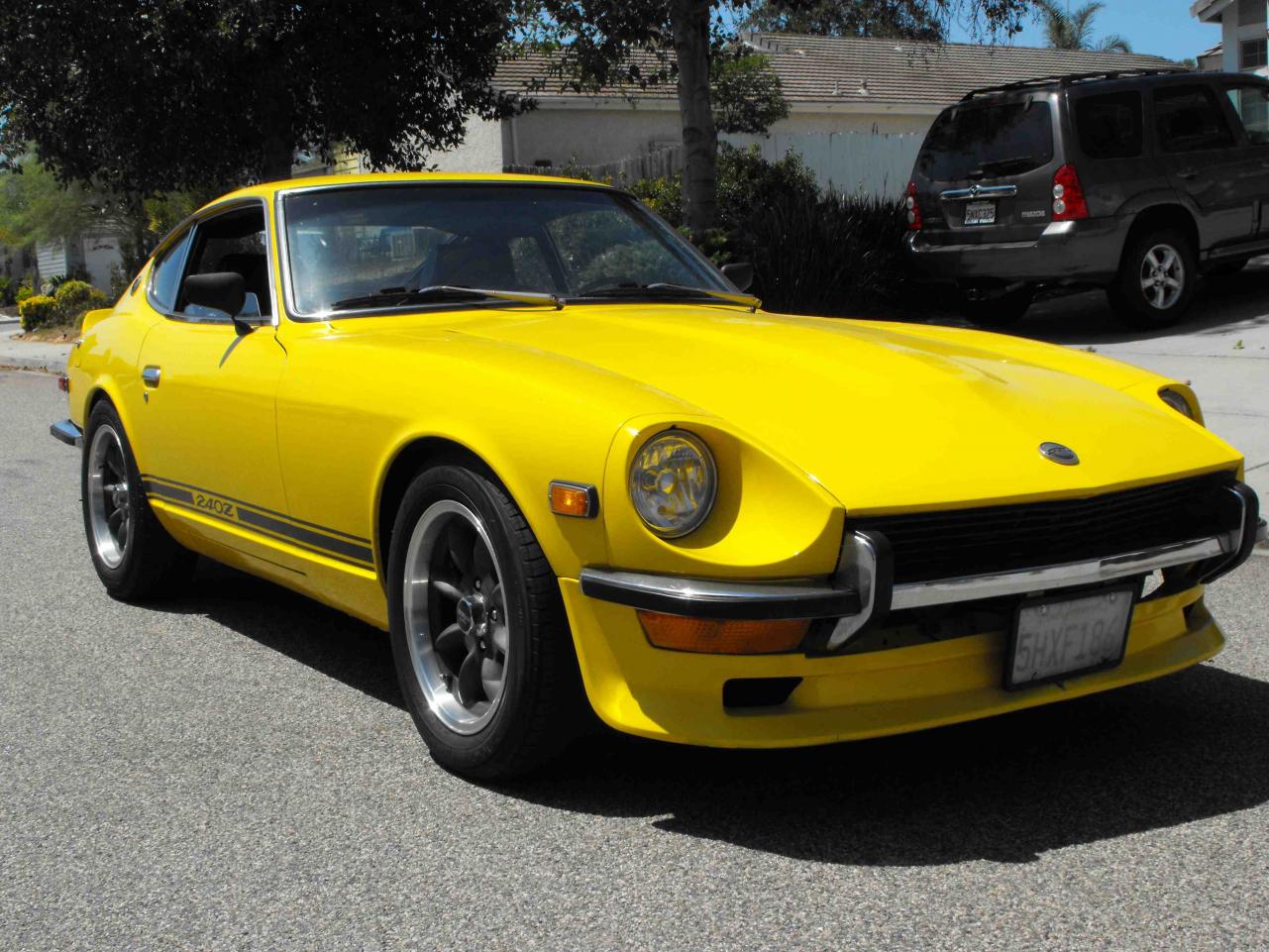

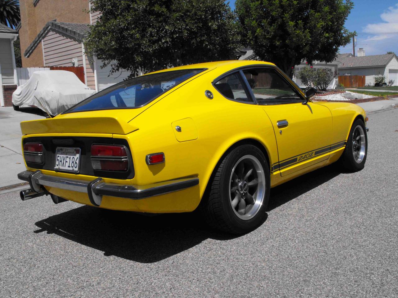

Here are the pics of the ride height on my Yellow Z with the Tokico 5 way's and the Eibach springs. I cut one lower coil on each of the front springs. This is exactly what I was looking for in ride height. I can slide my hand between the top of the tire and the fender well on both front and back. The wheels are 16X7 Panasports with 205/60/16 Yokohamas. The car handles great...I love it.
