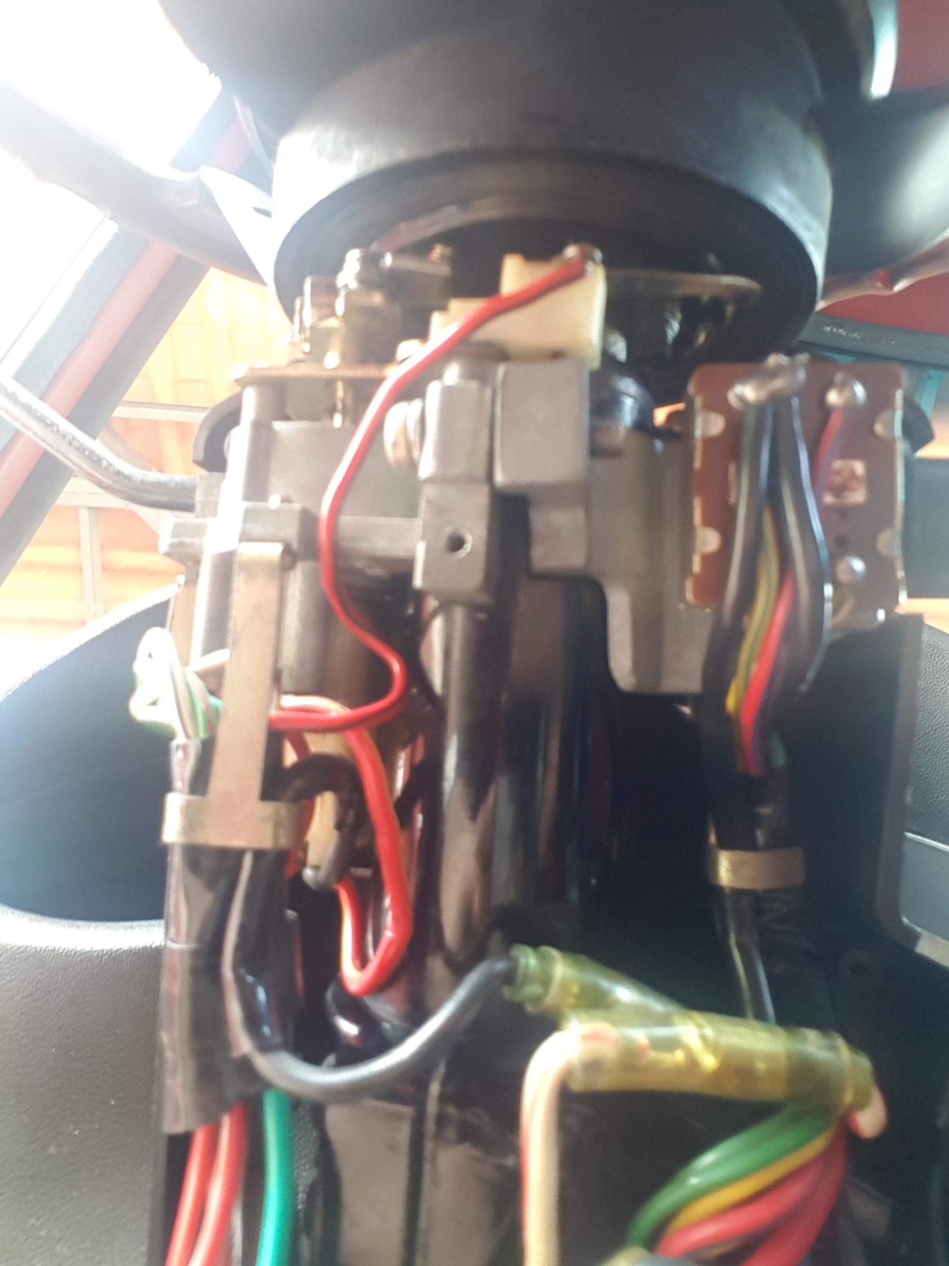

On 15/7/2011 at 6:17 PM, george71z said:
Okey-dokey. The front screw that goes into the combo sw. is a 12 mm thread length, counter-sunk #1 phillips head, with a 3 x .5 thread. The screw that goes into the ignition sw. is 11 mm thread length. pan head #2 philips head, with a 4 x .7 thread. It also uses an 11 mm dia flat washer and appropriate size lock washer.
Whats the size of the screw that goes here? Im missing this one.
