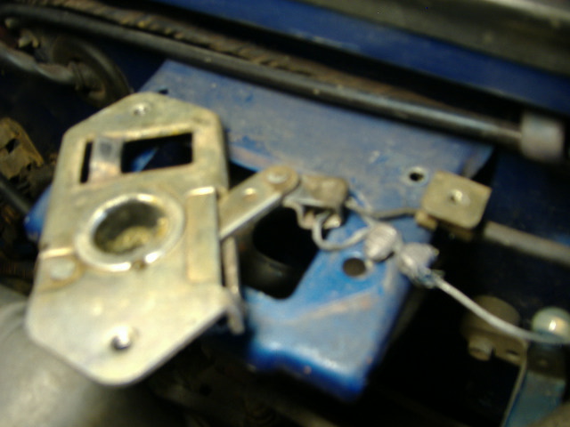

Could I get one of you fine people to post a pic of the 73 style latch where the cable connects so I can visualize my target. It would be a great help.

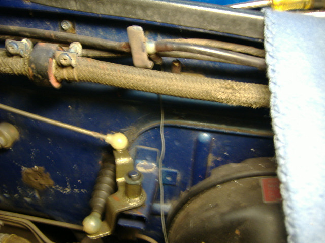

This is on my 73. I added an extra cable IF ever the original failed as I have read about. Hope it helps.
