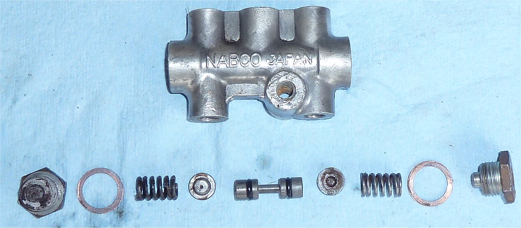

Posted May 20, 201114 yr comment_356301 Had one with bad threads. Needed the switch contact. Took it apart for your viewing pleasure: Link to comment https://www.classiczcars.com/forums/topic/39629-hydraulic-pressure-differential-switch-exploded/ Share on other sites More sharing options...

May 21, 201114 yr comment_356390 When I opened-up the valve on my 1972, it was stuck, but not fully frozen. Cleaned it up and it really made a difference in how the brakes felt. Link to comment https://www.classiczcars.com/forums/topic/39629-hydraulic-pressure-differential-switch-exploded/#findComment-356390 Share on other sites More sharing options...
