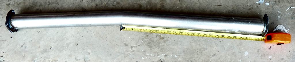

Posted May 18, 201114 yr comment_356130 Hey all, I'm once again thinking about exhaust, and I need some info from someone who has the MSA Premium flanged exhaust. I need the length of the longer straight section of the center pipe. Can anyone help me with this? Link to comment https://www.classiczcars.com/forums/topic/39611-customizing-my-msa-flanged-exhaust/ Share on other sites More sharing options...

May 18, 201114 yr comment_356172 Hi Arne, It is a pleasure. The pipe just has one bend so I measured along the shortest side of the pipe (inside line of bend) from the outer flanges to the centre of the bend. The measurement includes the flange's thickness. The longer side of ther pipe to the bend (between arrows in your photo) is 23.5". The other section from the flange to the bend is 18". The flanges are 3/16" thick. I bet you are thinking "glass pack" So am I. Link to comment https://www.classiczcars.com/forums/topic/39611-customizing-my-msa-flanged-exhaust/#findComment-356172 Share on other sites More sharing options...
