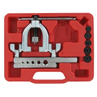

- tried two double flare kits Autozone $30 was junk, I did ~20 practice and actual attempts but none were good. The tool had inherent manufacturing flaws. I was so disappointed that I designed a new tool. (TBA). I bought a 2nd flare tool from Princess Auto (Canada's Harbour Freight equivalent... not a shop in San Fransisco LOL). It worked great.
bad kit:
4
good kit: 2990245.jpg
http://www.princessauto.com/workshop/hand-tools/trade-tools/electrical/2990245-double-flare-tool-kit
