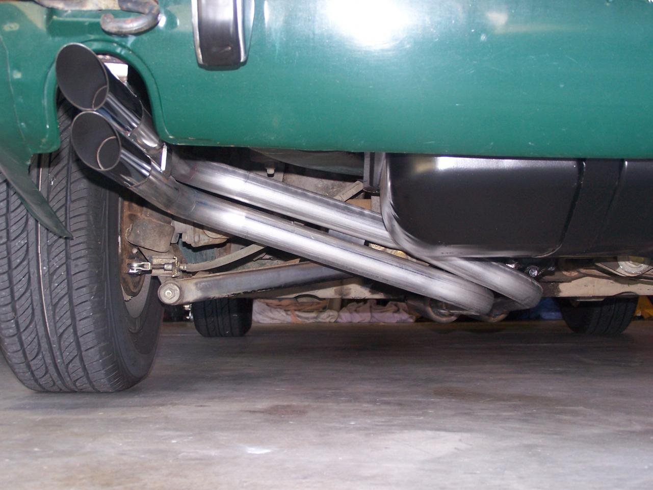

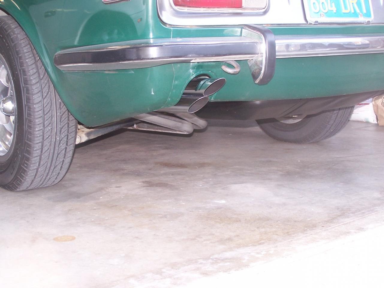

When I got my car, my twice pipes and glasspacks were pretty well toast. I liked the way they sounded, but way too loud since one actually had a hole in it and the first start after 23 years of storage pretty much blew out any of the rest of the packing. I had a guy here locally do the work for me and I'm quite happy. He ran the over under section a lot tighter than the original set up and it sounds really nice. Maybe a little loud on hard acceleration for some, but at cruise it sounds fantastic. I'll post a couple pics
Great looking set-up. What shape was your front pipe in? I bet your car has an interesting story...why did it sit for 23 years?!
Nice! I'm planning to do the same, any driving videos? I keep thinking that the system will be too loud for me.
24oz- My guy replaced everything from the exhaust manifold back. As far as the story goes, kinda O.T. but the lady I got it from bought it from original owner in '73 with a little over 7k miles on it. She and her husband, her mostly, drove it up until about '87 and just under 81k miles. They ended up buying another car and the Z was relegated to barn storage. Lady's husband was a mechanic by trade and kept the Z in awesome mechanical condition. Husband passed away about 6 years ago.

Leon, no videos but I could try and get a short clip tomorrow. Like I said, it is a little loud when you are on throttle hard, but cruising and fwy speeds are not bad. No droning at all
Good to hear! I like the way your exhaust tucks into the valence, looks like a clean job. Are you using the stock manifold, and if so did you get a new collector pipe to hook up to the manifold or did you reuse the old one?
I'm thinking of going with a system similar to ChrisZ's, with twin pipes hooked up to my Clifford header (or maybe stock manifold) utilizing 2 glasspacks per pipe. You only have 1 pack per pipe, so I may go with that if there isn't much highway drone and it's not too loud, except of course at higher throttle openings/engine speeds.
Thanks for the feedback!
Leon, I'm using the stock manifold with the original collector pipe. He cut the original collector pipes about 4" or so downstream and welded the new pipes to them. If I ever decided to go the header route, it would be really easy to add it in but my engine is stock, so I don't see much need for a header.
Gotcha. I would use the stock manifold but the flange on my collector pipe is warped and finding a new/good one is pretty tough, thus the consideration for the header. Again, thanks for all the info!
