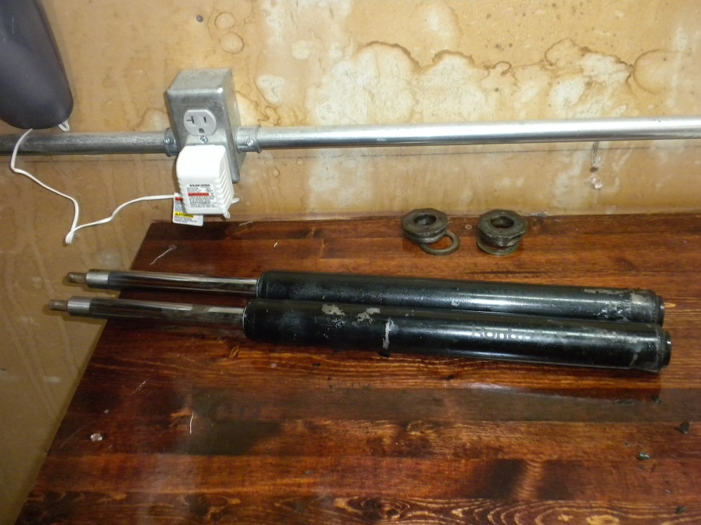

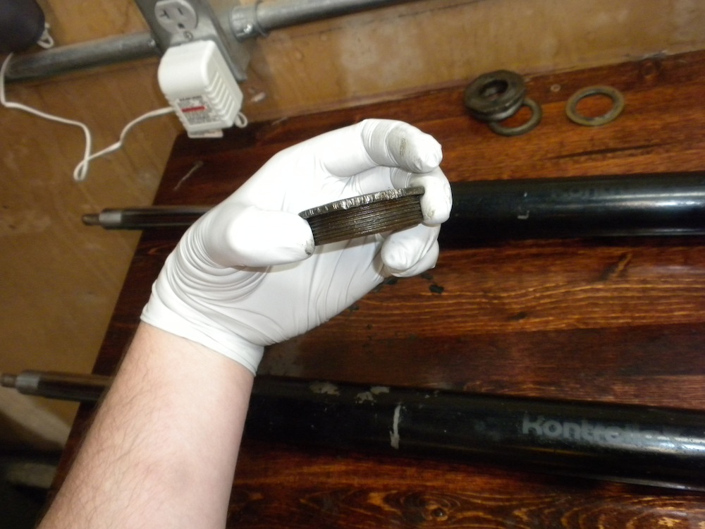

April 5, 201114 yr Author comment_352091 Thanks Mike, Yeah I have been trying to track down info this is the best I came up with. With them being slightly better rated than the KYBs oh well worth checking. http://www.zhome.com/ZCMnL/tech/suspension.html Here are some photos for all to complete the thread. Tried to take a photo of the part number but it did not turn out well. Link to comment https://www.classiczcars.com/forums/topic/39129-kontrolle-shock-tubes/#findComment-352091 Share on other sites More sharing options...

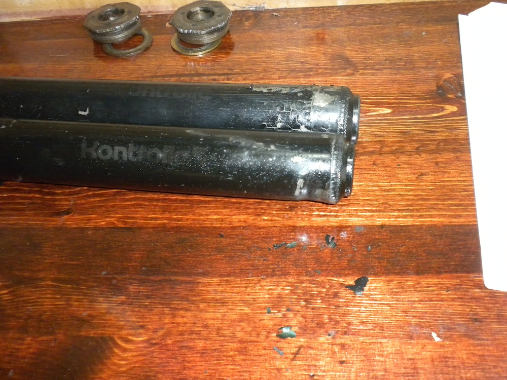

May 23, 201114 yr Author comment_356556 Well after much hard work I finally got the stuck shock out of the tube on the orange car. What would you know it is also a Kontrolle, despite being told that two owners ago they replaced them with KYBs. It looks different than the other two fronts I have. Thanks again to everyone for the information. Should be able to get the new Tokico Illuminas in now. Link to comment https://www.classiczcars.com/forums/topic/39129-kontrolle-shock-tubes/#findComment-356556 Share on other sites More sharing options...

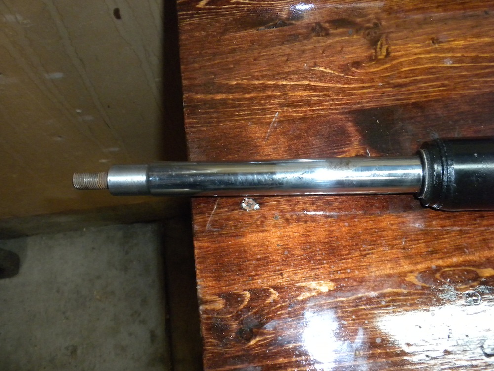

May 23, 201114 yr comment_356594 To satisfy any curiosity... Link to comment https://www.classiczcars.com/forums/topic/39129-kontrolle-shock-tubes/#findComment-356594 Share on other sites More sharing options...
