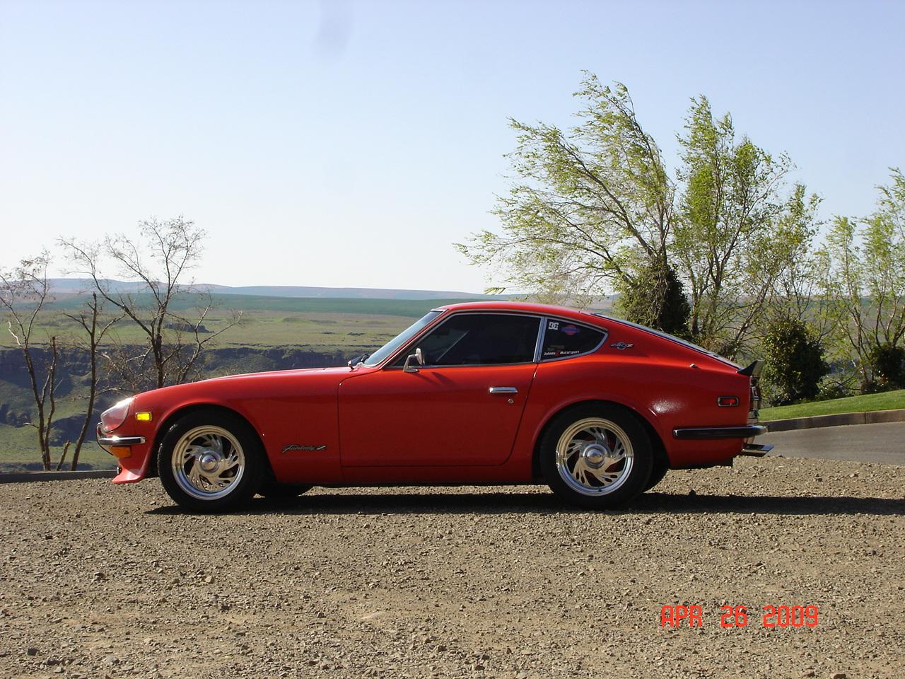

About 1" yes. Maybe a little more due to use and time. they sit lower as time goes by. Very typical of Eibach Progressive rate lowering springs, but I love them.
280Z's are heavier but I think Eibach did a stronger, taller spring for the 280Z's

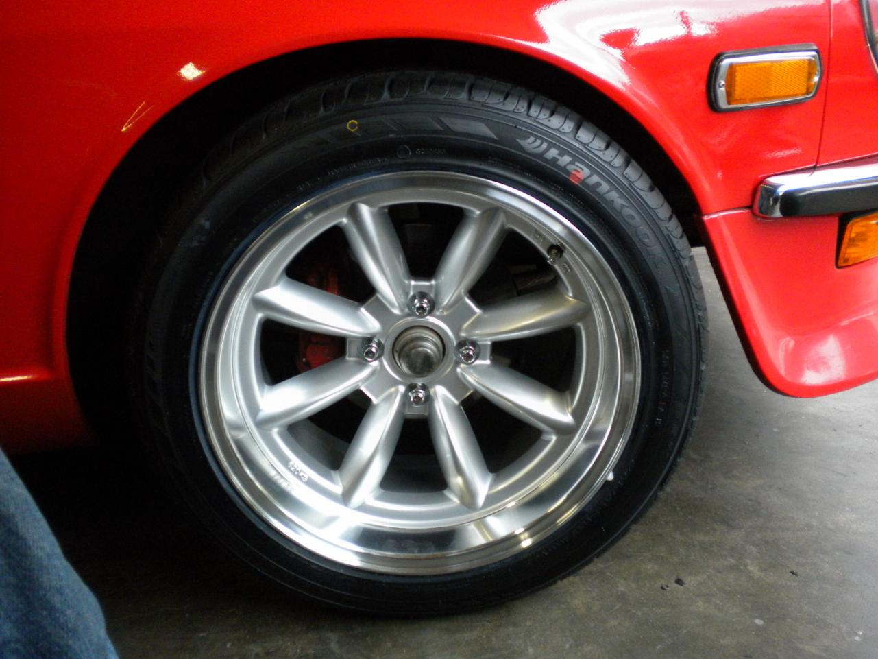

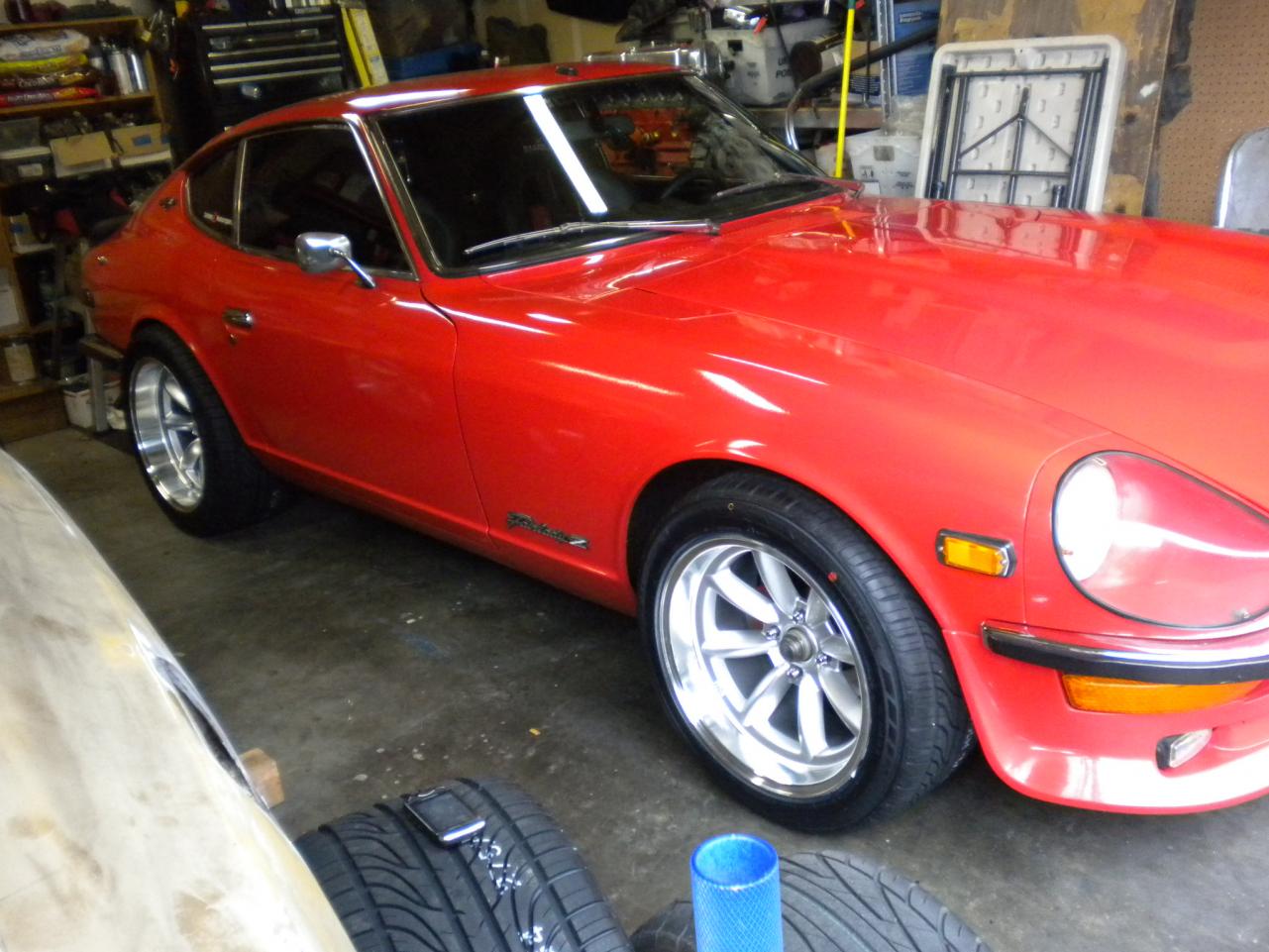

You won't find very many 17" owners on this site. but I can tell you that 17x9.5 Rota's with 275/40ZR17 Hankooks won't fit on a lowered 70' 240Z.
And there are 17x8's (-13 offset??) on the front with 245/45ZR17's (-19 offset ??) Just a test fit to see how they looked. Couldn't steer and would had rubbed in the rear had I tried to drive it.
Dave

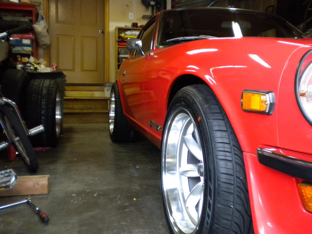

16x7, +12mm offset, 225/50-16 with 1" drop (no rubbing)

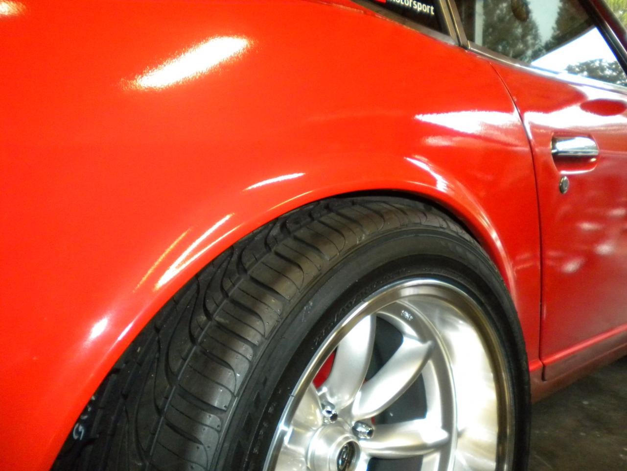

16x8, 0-offset, 225/50-16 with 1" drop (rear tires rubbed fender occasionally)
Steering effort when parking is difficult with both.

I'm not into lowered suspensions, fat tires, and hard steering (from fat tires). So it might seem like high water pants to some of you guys, but here's my combination that fits and works well. I'm running Bridgestone Potenza G 019 Grids, 195/60R15 on 15x7 Panosport rims:
The previous owner was running T/A radials, 215/60R15 on the same rims, and those rubbed on the front wheel arches when turning the wheel moderately.

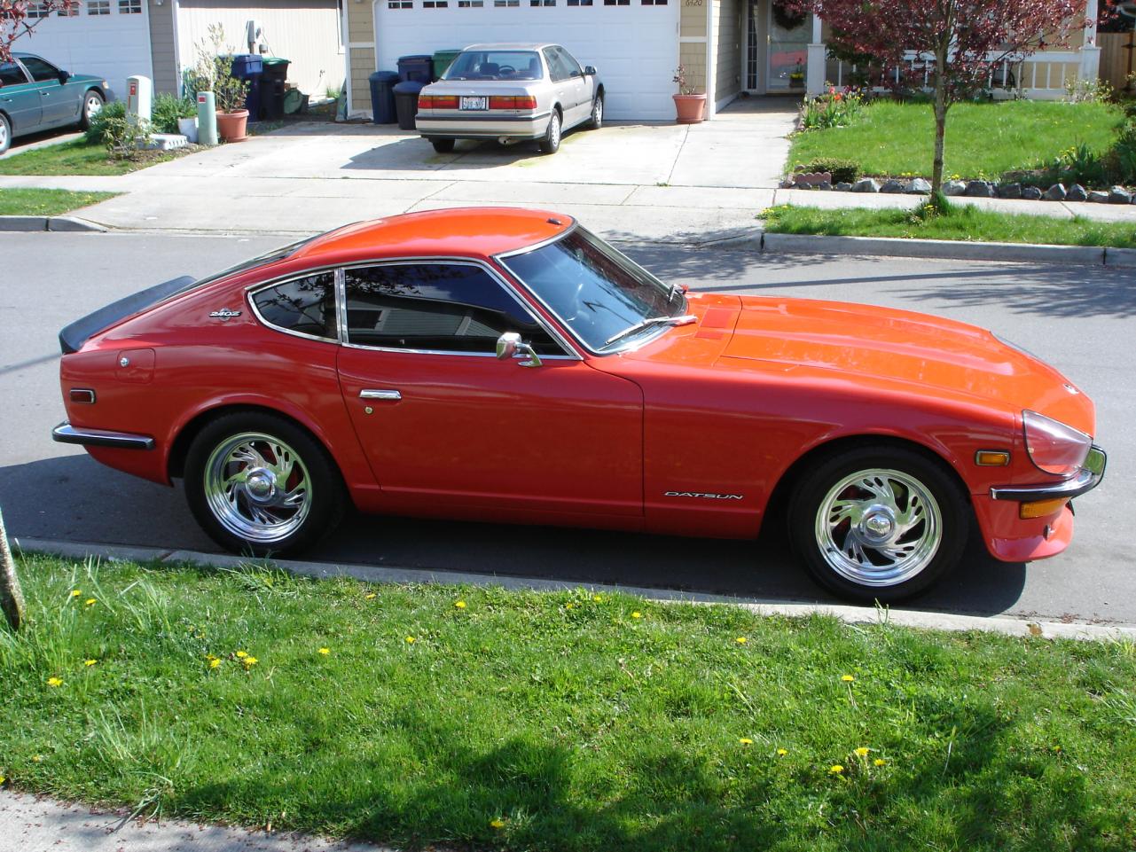

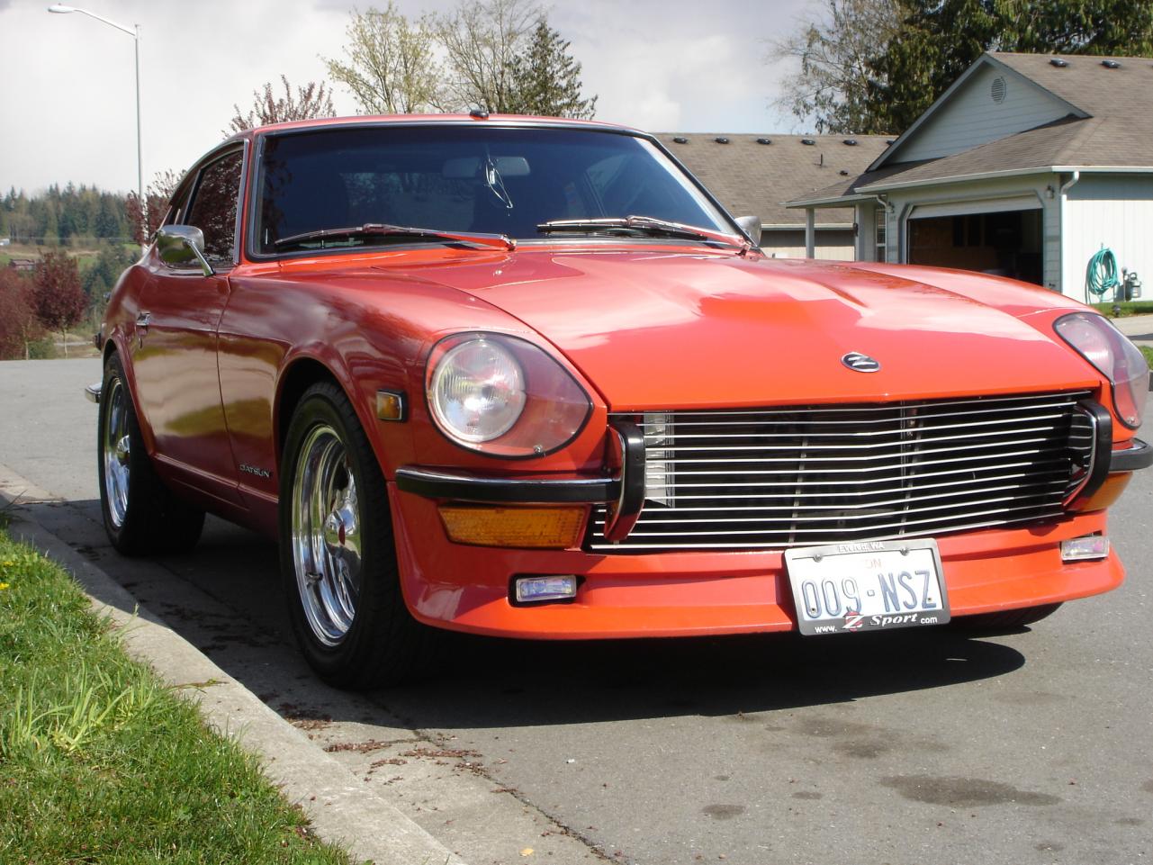

i love the look of this Z. about the perfect stance as far as i'm concerned. but why the change in backspacing/offset between this car and the other you posted?
