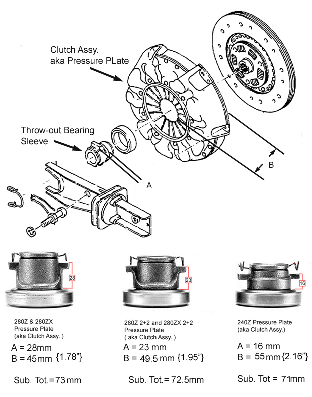

February 15, 201114 yr comment_346008 I also double checked the heighth of the fingers on the pressure plate. It was close to 1 3/4", not the 2" required for the 240 collar. Argh. From my notes: For 1.75" high fingers - the throw-out bearing sleeve should be 28mm. The Part Number is 30501-1C104 (about $18.00 suggested retail from Nissan). FWIW, Carl B. Link to comment https://www.classiczcars.com/forums/topic/38512-toasted-clutch/?&page=3#findComment-346008 Share on other sites More sharing options...
February 15, 201114 yr comment_346018 Is that the typical place to measure the sleeve/collar? The 1 13/16" collars I mentioned, also measure out to 28mm (~ 1 1/8") using Carl's measurement points. One more data point.It looks like hogie has all of the parts for a 280Z coupe clutch. What are the measurements on the original parts that didn't work? Link to comment https://www.classiczcars.com/forums/topic/38512-toasted-clutch/?&page=3#findComment-346018 Share on other sites More sharing options...
February 15, 201114 yr comment_346022 Here is an older diagram I was working on.. but wanted to verify the measurements before publishing... The Throw-Out Bearings are about 19mm. So add 28mm+19mm and you get pretty close to 47mm or 1.85" or 1 13/16's inch. FWIW, Carl B. Link to comment https://www.classiczcars.com/forums/topic/38512-toasted-clutch/?&page=3#findComment-346022 Share on other sites More sharing options...
February 15, 201114 yr comment_346025 Thanks for the information Carl. I wil be saving this thread for future reference. I wonder if hogie had a 240 mm (2+2) pressure plate with a 28 mm sleeve similar to ktm's situation in the other thread, but somehow the PO got it bolted together?hogie, if you want to be sure that your slave cylinder is not bottomed out, holding some pressure on your pressure plate fingers, note that on my car, I can pull the slave cylinder rod back and remove it from its spot on the fork without unbolting anything. There is enough unused travel in the slave cylinder to do that. If your slave cylinder was bottomed mechanically, you won't be able to do that. Edited February 15, 201114 yr by Zed Head Link to comment https://www.classiczcars.com/forums/topic/38512-toasted-clutch/?&page=3#findComment-346025 Share on other sites More sharing options...

February 15, 201114 yr comment_346047 Hi Hogie:Make sure you measure the height of the clutch pressure plate fingers and let us know what you received. Also check the actual length of the collar and compare them to the diagram I Posted..Pictures of the ZOOM and MSA Pressure plates side by side would be GREAT...thanks,Carl B. Edited February 15, 201114 yr by Carl Beck Link to comment https://www.classiczcars.com/forums/topic/38512-toasted-clutch/?&page=3#findComment-346047 Share on other sites More sharing options...

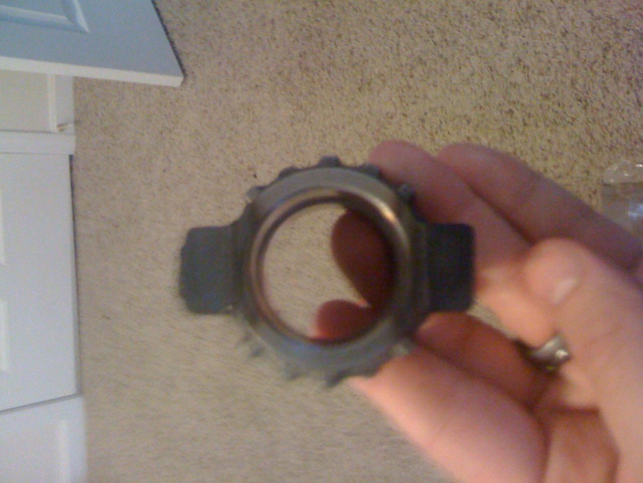

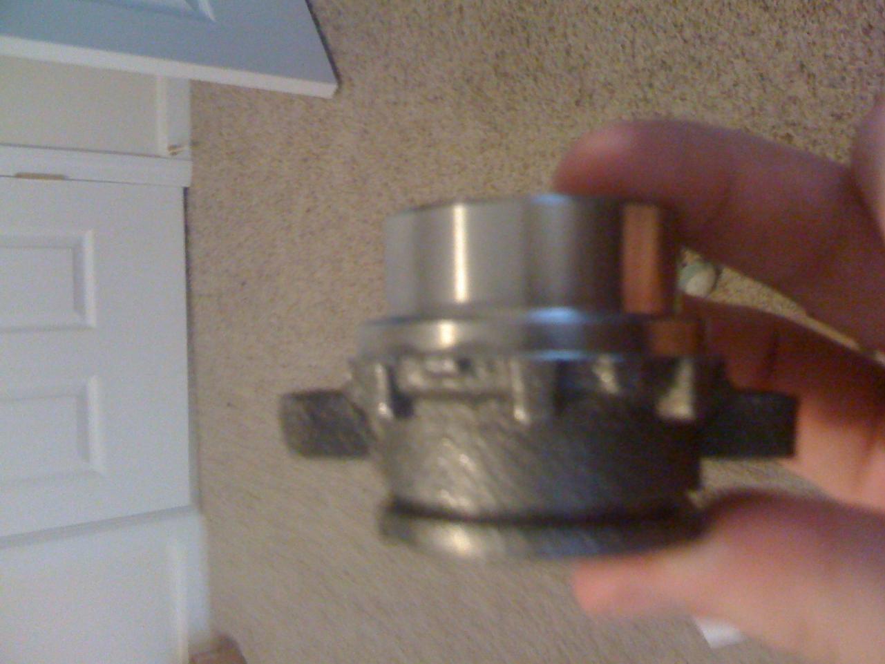

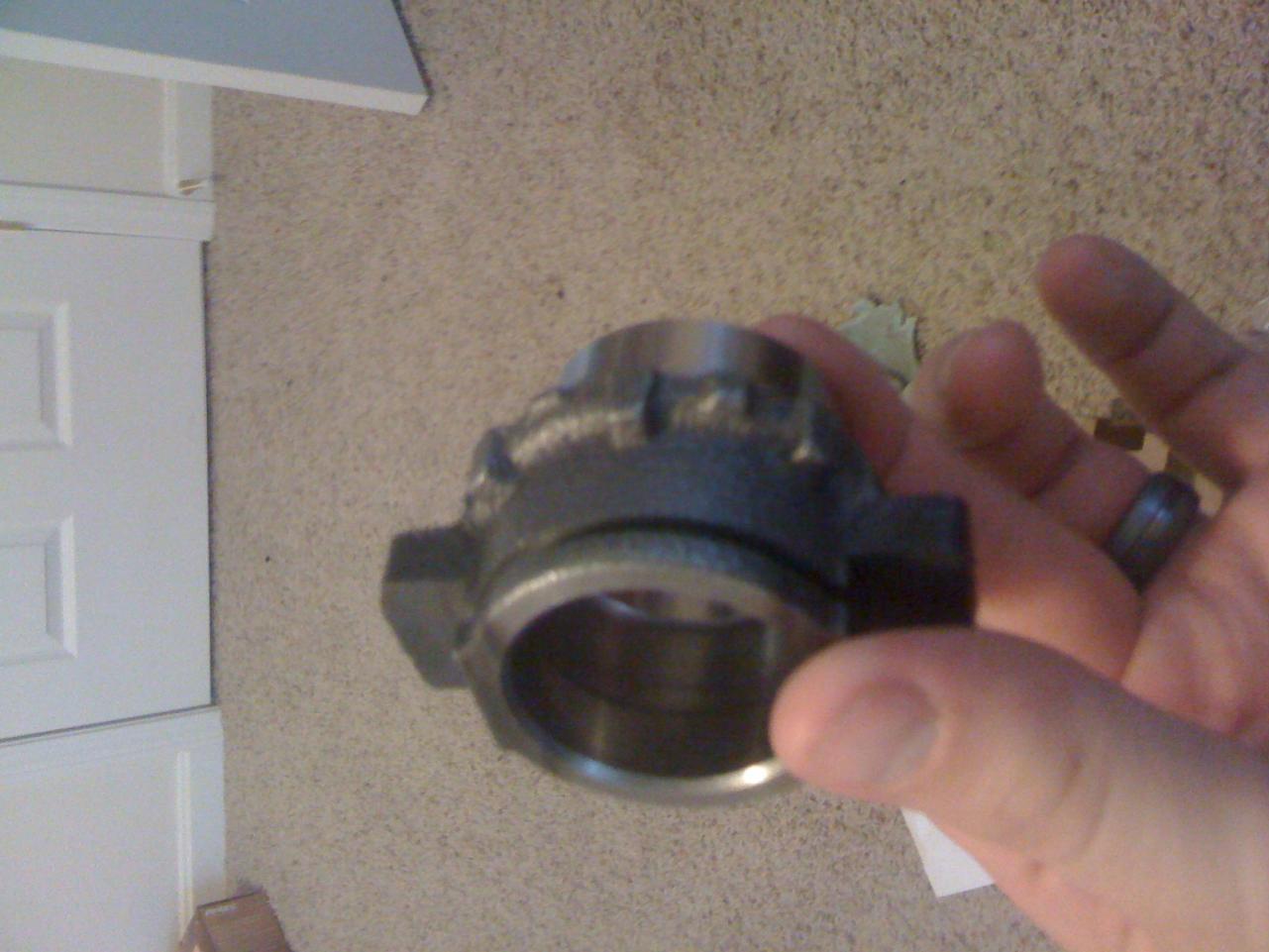

February 18, 201114 yr Author comment_346452 Ok, MSA sent me the following part...however it looks nothing like any of the clutch collars I have seen. Does this look like the proper collar? Sorry for the fuzzy pics. I haven't seen any of these online with the blocky projections from the body. Also, I swear if you google the part number it comes up as a 350z part. Unfortuneatly, I don't have the box in front of me. I just got a call back from them and they said this part superceded the old number and that it is used in a ton of vehicles. Edited February 18, 201114 yr by hogie Link to comment https://www.classiczcars.com/forums/topic/38512-toasted-clutch/?&page=3#findComment-346452 Share on other sites More sharing options...
February 18, 201114 yr comment_346465 Howdy hogie. It does look different than old factory stock but the necessary bearing surfaces are there. The tops of the ears and the bearing and the spring clip are the only contact points. If you look at Carl's pictures in Post#31, you can probably figure out where to measure from to see what you have. They sent you the collar/sleeve with no bearing, so you'll have to measure from the top of the ears to where the top of the bearing would be.It does look like a short one though. Maybe a 240Z collar/sleeve. If so, it certainly won't jam your clutch partially open, but may not disengage it fully either. You might need an adjustable slave rod.Edit - actually it looks like it might be designed to handle two different bearings. I would guess that your bearing will only press up onn the narrow section, so it is probably taller than it looks in use. If you have a bearing, you could guesstimate where it will end up once pressed on take a measurement there.I looked back at your pictures but can't read the tape on your measurements. How does the new one measure out compared to the old one? Edited February 18, 201114 yr by Zed Head Link to comment https://www.classiczcars.com/forums/topic/38512-toasted-clutch/?&page=3#findComment-346465 Share on other sites More sharing options...
