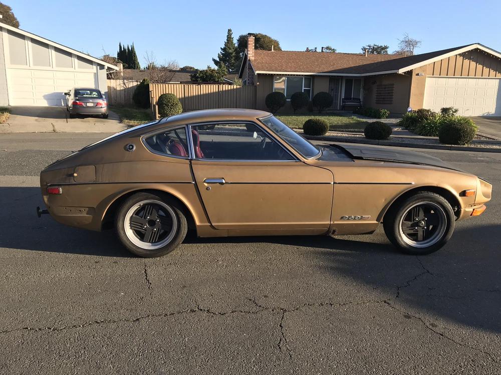

@LeonV have you made any changes to your setup? I have a 12/73 260z and I put what I believe are 280 tokico springs on the car.
the car is too damn low! I can’t even get my low profile jack under it! I used to be able to just slide under without a jack!
I’m not sure how to approach this. I saw that there are metal spacers that are available...
https://zcardepot.com/products/upper-strut-mount-spacer-240z-260z-280z#&gid=1&pid=3
which should take up 0.7” of the 1” perch difference, unless there is a 1” option somewhere...
@heyitsrama you installed the wrong springs, 12/73 is an early 260Z. The 280Z gets a shorter spring in the rear due to the taller isolator, if I’m not mistaken. You should fit 240Z springs or install 280Z rear top mounts. However, 280Z spring rates are stiffer than 240Z so you will end up sitting a bit higher. That’s not necessarily a bad thing, just depends what you’re after.
@LeonV it seems that changing out the rear strut isolator to a 280z is more cost effective than replacing all the springs, I’m reading in other threads that it should account for 3/4” of increase in height.
would keeping these 280z springs mean I would retain a more “sportier” feel in the suspension?
If by sportier feel, you mean higher ride frequency, then yes. Whether that’s a good thing is another discussion.
You should be able to find used isolators pretty easily. A spacer will more less do the same job, yeah.
