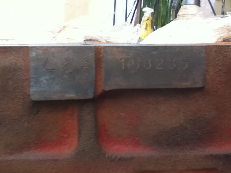

hi, i just brushed mi engine block and saw that is the P30
the head is E88, so the engine in my 260z is the L24, im i right ?

Don't trust what you read on the web. What is the engine serial number as stamped on the block below the plugs for #5? It will either start with L24 or L26. Don't trust the casting number.
mike260z, it says on the page that you linked, that the P30 was used for both the 240Z and 260Z.
Arne's suggestion gets right to the best way to find out. It is stamped on the block. Right above the starter, a flat spot. You might have to scrape some grime off to read it.
Good work. An L24. Is that the engine in the car or the extra? That's one, what does the other engine show?
