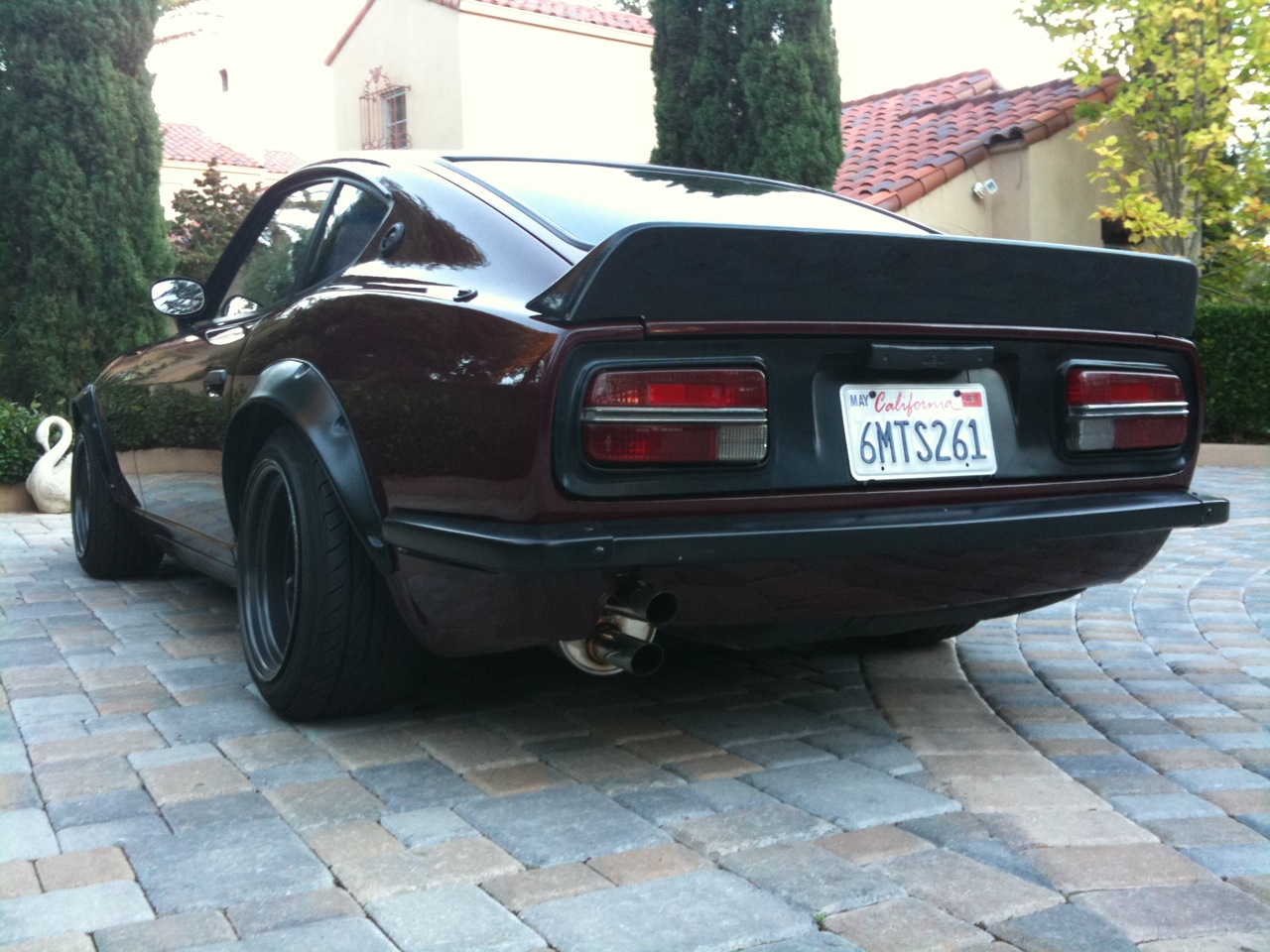

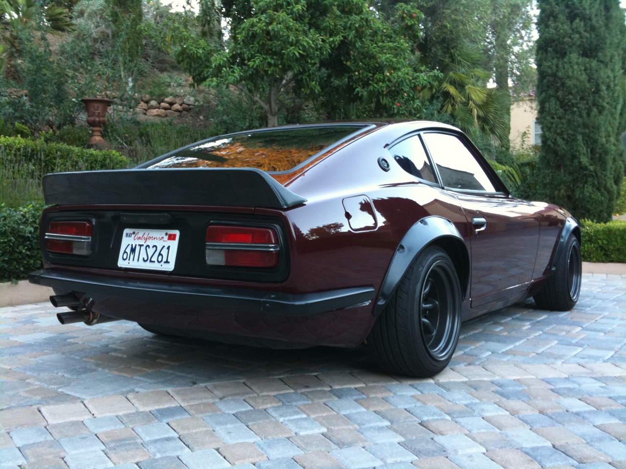

I can confirm that this exhaust DOES work. My close friend, who has a gnose 71 240Z, has this exhaust and ordered it from rhdjapan.com. He had a custom mandrel bent flange mated to it so it could be fit to the MSA header. Other than that, the exhaust fits perfect and sound. Do consider however that you may not want to purchase it for an overly LOW car though, as it does tend to hang a tad low. Let me also say, this is by my opinion, the BEST sounding exhaust on a early Z car. The dual pipes release a solid, NON-DRONING, sound at low and high rpm's.
I can get a picture of the exhaust on his car for you. I'll ask him.

It is, and it does sound awesome. Glenn is right though, it does hang a bit low. He is on coilovers though so his car is pretty low

That would be awsome if you can grab some pics. We are having trouble confirming fitment but if he has them on his car then it should be all good.

It's really the middle muffler (resonator?) that hangs low. The muffler and tips look great but the middle pipe is just low
