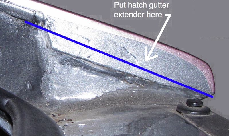

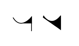

I have been wondering if there is an easy way to keep water off of that flat area under the back hatch. The idea hopefully would be to find a ready made item that could be modified to make an "extended gutter" that would divert water coming down the hatch gutter on the lip of the hatch opening on the sides to prevent it from being dumped on the flat area in back so that it continues on and gets dumped outside the car. I won't mention how long I have been trying to figure this out (a year?). If anyone has any ideas at all on this I would like to see them. See attached pictures for what I was thinking though there may be better ideas. The drawing is an end view of an extended gutter that would be siliconed I guess to just above the flat area on the sides from just under the existing gutter to just beyond the flat area.

IMO, if you just wanted to extend the little gutter-thing that goes down the sides of the hatch opening, you'd also have to cut out the lower corners of the hatch or at least trim off the lip, so the water will drain off the back to the ground, instead of going around/behind/through the tail lamps.
