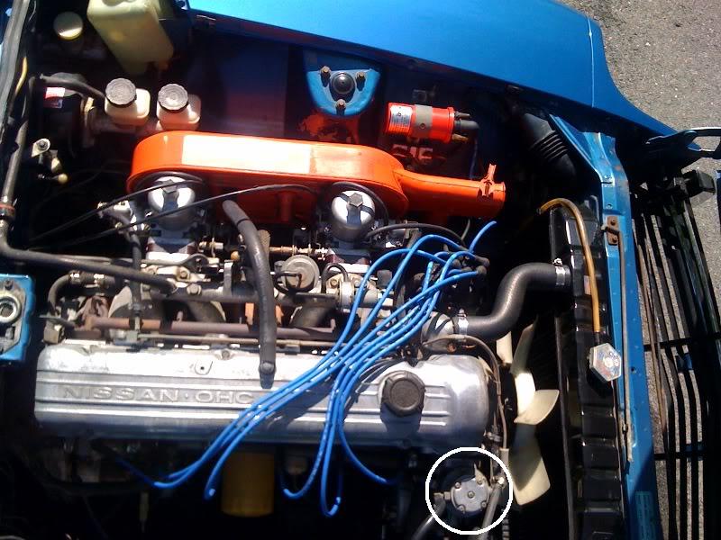

as well im still having a hard time locating exactly where on the engine the mechanical pump is...
thank you
thank you for the pic,
i noticed that my car doesn't have one by the engine, in its place is just a filter, does it need both pumps to function properly
