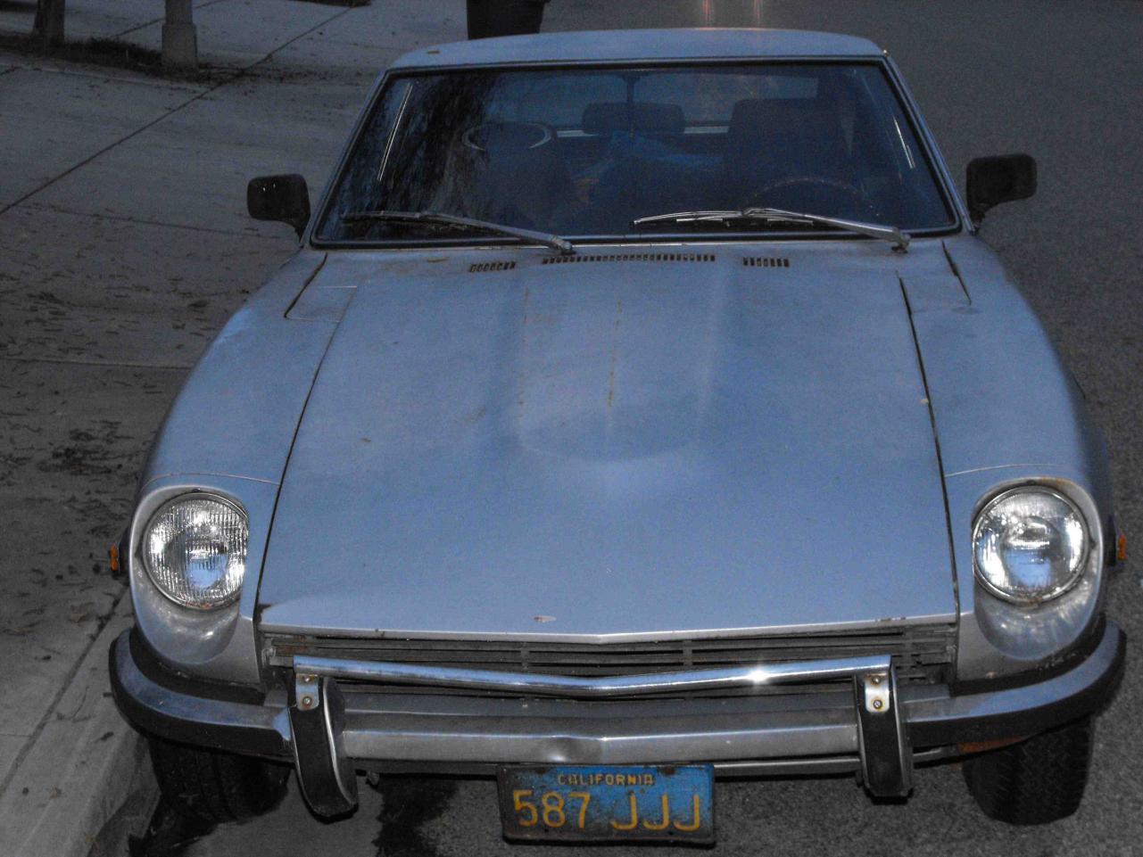

I love Craigslist for buying cars. Nice selection and in my opinion, some great deals. You also get quite a few dreamers on there as well. Anyway, when I saw the ad on Craigslist for the ’73, I was very impressed by the original look and the motor pics that looked to be untouched. All that funky insulation was intact as was the smog and the flat top carbs. The owner wanted $1300 for it. I called the owner to see the car, at which point he mentioned he could no longer start the car. I told him that was fine, I would still like to see it.
When I arrived, the owner was still trying to start the car. I did a quick inspect and tried to help him start it but no luck (later found out it was a bad fuel pump). Since he couldn’t start it, he on the spot lowered the price to $900. That was nice, no need to haggle down the price. I checked the car over and was thrilled. There were two minor rust spots behind the rear wheels, not bad. Radiator, radio and seats were not original, otherwise it was not too ‘molested’. The seats were a nice pair of Recaro’s which are now in my sport yellow Z. The owner had bought the car for his son to ‘fix-up’, but the son lost interest. The seats were as far as he got, fortunately.
The owner was very excited to show me the blue carpet that he had bought to ‘re-do’ the complete interior.:sick: He was insistent that I take it to complete the car by gluing the carpet over the vinyl black diamond interior. The funny thing about this is that the original vinyl inside is nearly flawless as are the door panels-better than my ’70 even. Makes me cringe to think he would have tossed that to put in the horrendous blue carpet.
The owner was really quite cool, though. He is the author of a very popular robotics book and he gave me a free copy. I helped with my sons’ robotics team at school, so we had a lot to talk about. Anyway, I got my wife to agree to car number 6 and paid cash for it the next day as I picked it up with the u-haul trailer. Now the fun begins

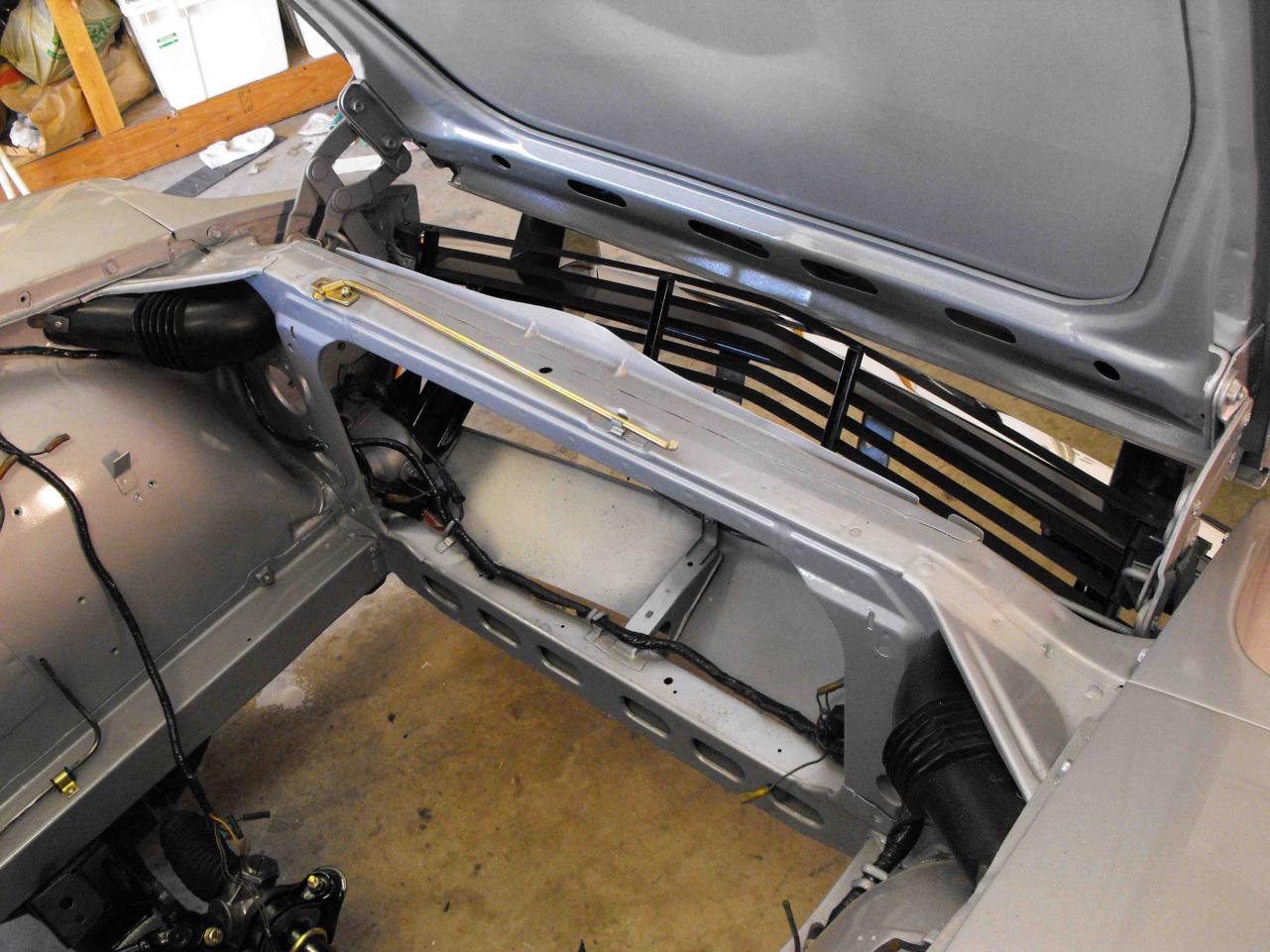

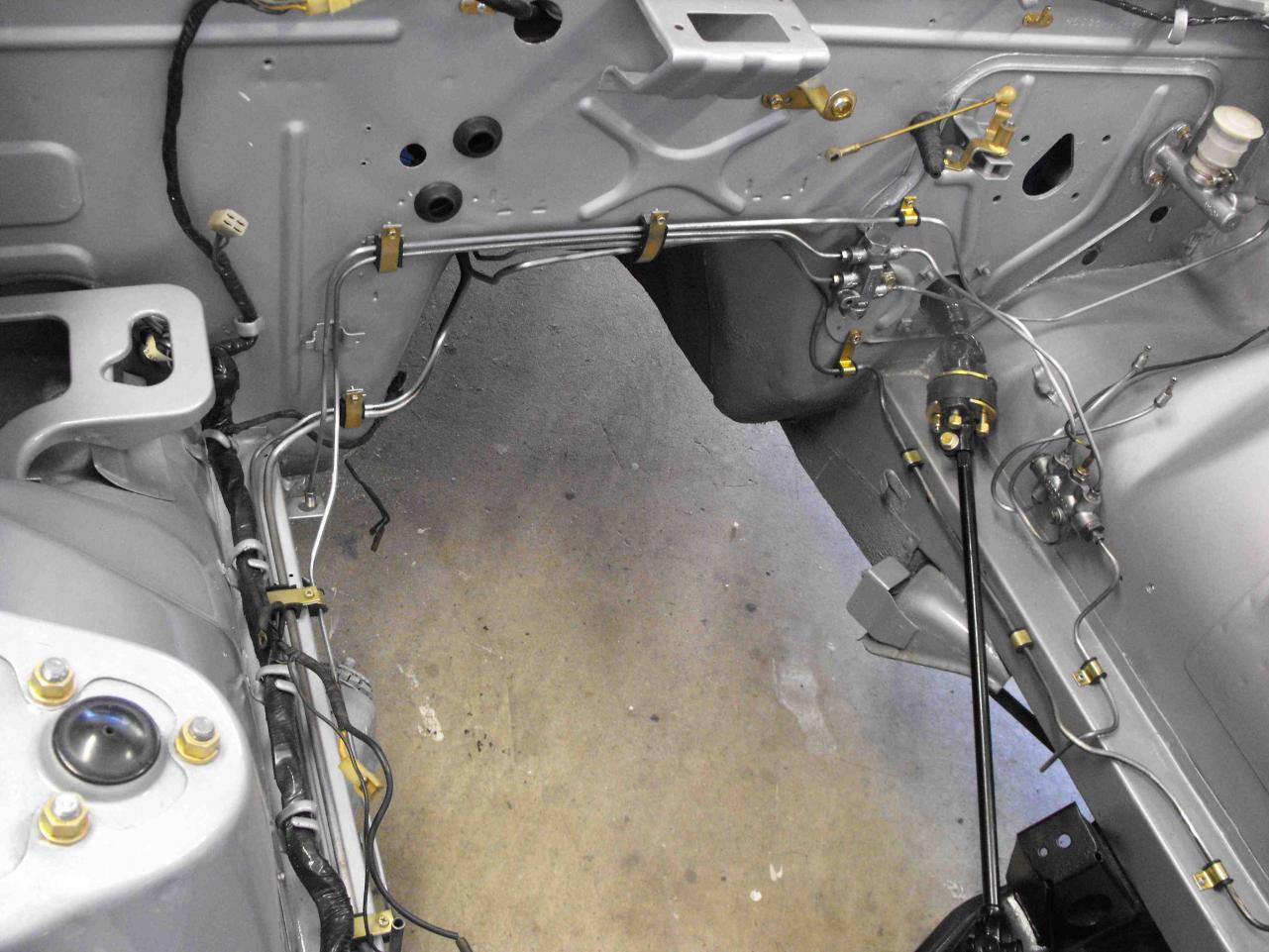

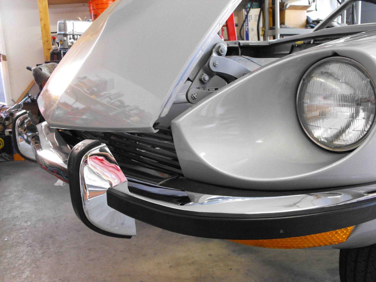

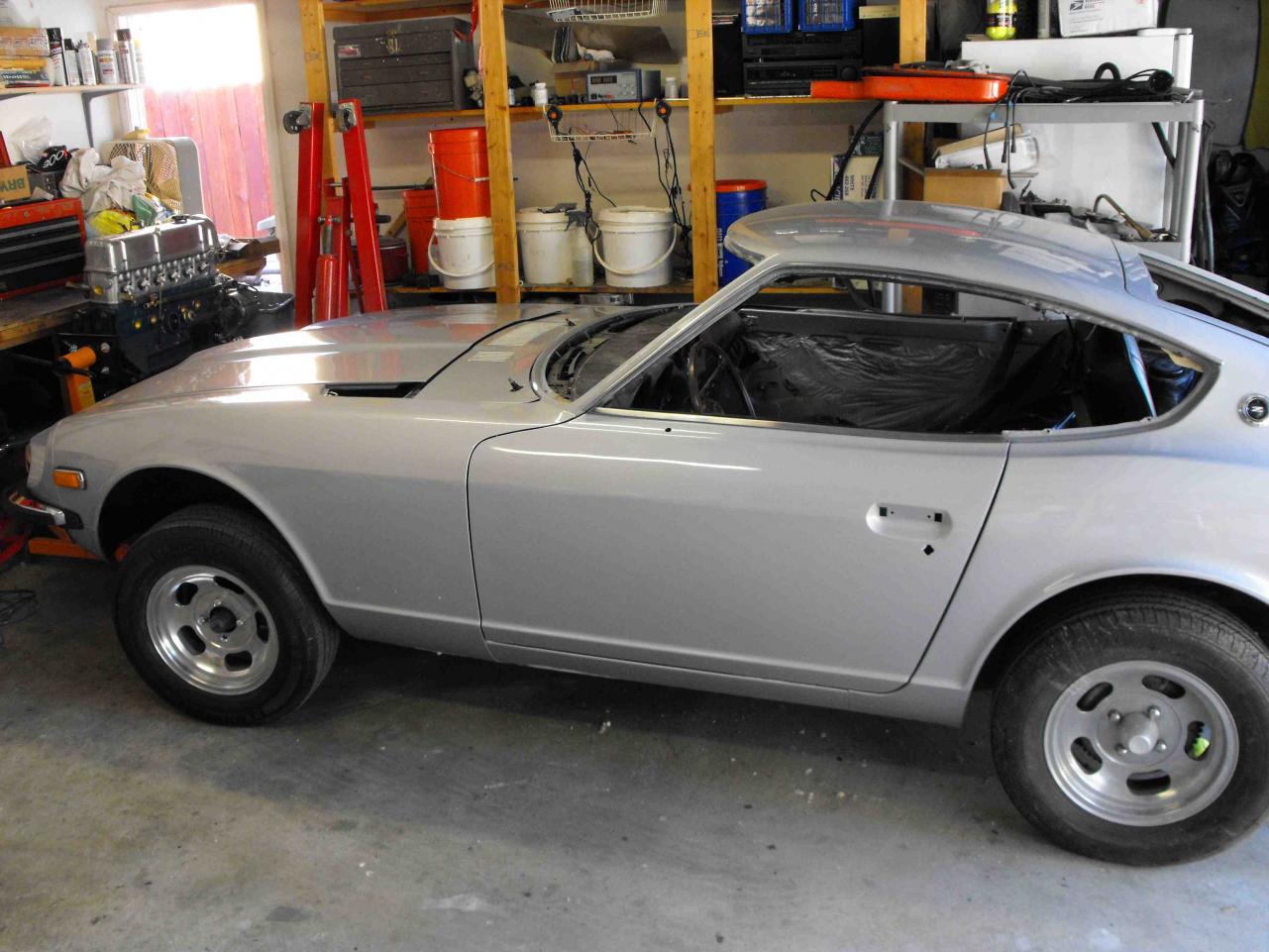

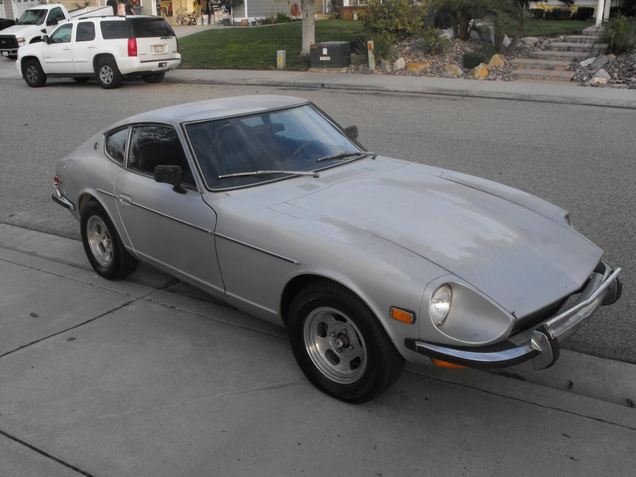

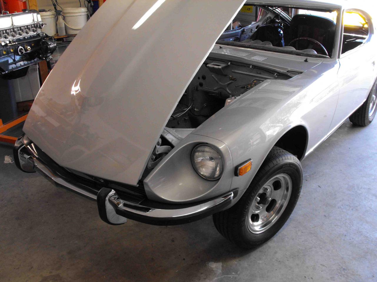

Got the front bumper in. This was one of the items I did not intend to 'upgrade', but closer inspection said they needed help. Thus the re-chrome and new front bumber strips. This is $800 that I did not budget in originally(both bumpers chromed, towel bar holes welded up, 2 new front rubber strips). I do love the look though. I painted the grill with the same paint I used for the back panel. Also completed the brake and fuel line clean-up. Dropped the flywheel off to get surfaced at the machine shop. If I can get the time, will get the motor in next week. Here are the progress pics. Also threw in a before picture.

what do you use to recoat the bare metal hardware to get that original yellowish gold look ?
I use the Caswell zinc plating kit.
http://www.caswellplating.com/kits/zinc.htm
I like doing the plating myself because it is convenient and I can get the exact finish I want. I can control the brightness, rainbow, and color darkness ...for the most part. Some metal types are harder than others.
