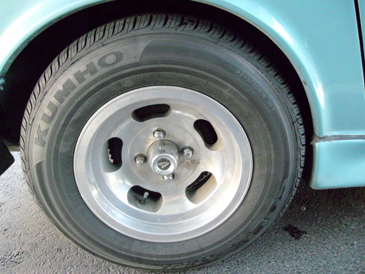

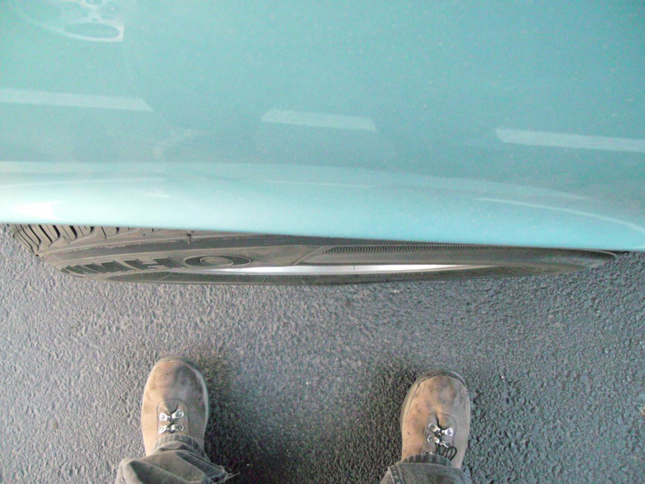

July 5, 201015 yr Author comment_324515 A bit of an update and I hope you all can help here: I took the Z to my other mechanic to get the alignment done. In the process he found that there is movement in the rear right wheel (the one that makes the noise) and advised me that the bearing is bad. (loose). He reconfirmed that the rear struts are worn to bits and they need replacement. Secondly we found that the rear end wheels have a 5/8" toe in on both sides. As these are non adjustable does anyone know what could cause them to do this? I took two pictures so you all can see what I'm dealing with. On a side note, the front tires also had toe in of 5degrees (roughly) on both sides. That was fixed but the rears are still a bit odd. Any help would be great Jan Link to comment https://www.classiczcars.com/forums/topic/36369-new-tire-sounds/?&page=2#findComment-324515 Share on other sites More sharing options...
July 6, 201015 yr comment_324520 A bit of an update and I hope you all can help here:I took the Z to my other mechanic to get the alignment done. In the process he found that there is movement in the rear right wheel (the one that makes the noise) and advised me that the bearing is bad. (loose). He reconfirmed that the rear struts are worn to bits and they need replacement. Secondly we found that the rear end wheels have a 5/8" toe in on both sides. As these are non adjustable does anyone know what could cause them to do this? I took two pictures so you all can see what I'm dealing with.On a side note, the front tires also had toe in of 5degrees (roughly) on both sides. That was fixed but the rears are still a bit odd. Any help would be greatJanGetting closer! I was going to say bearing. Seriously. Anyway...Your transverse link bushings determine the alignment of the rear wheels (assuming that their mounting points to the body are not misaligned). Are they worn? There are two inner, where the wide part of the link attaches to the frame, and two outer, where it attaches to the strut/bearing housing (the cast iron piece) via the spindle pin. If the inner ones are worn, I've heard (read) that you can get quite a bit of movement of the whole assembly. I think that it would give toe-out under braking, toe-in under acceleration.There is an account out there from someone about being able to move the whole wheel assembly by hand because the bushings were shot.There is also talk of poorly drilled bearing housings, from the factory.I still have my stock bushings though, and my rear alignment seems pretty good, so can't offer much more. Link to comment https://www.classiczcars.com/forums/topic/36369-new-tire-sounds/?&page=2#findComment-324520 Share on other sites More sharing options...
July 6, 201015 yr Author comment_324535 Well if the transverse link are the rather large A looking parts of the rear suspension(that hold the wheels to the frame) then I don't think the word "worn" gives justice to what I have left. On all eight I have maybe an inch or two of "bushings" left. These "bushings" are broken, cracked and torn all over. Could having bad rear bushing really cause 5/8ths of an inch of toe in? To be more specific, pretty much all the rear bushings on my car are shot. The mustache bar bushings are gone so when I shift I get the dreaded "thud". The drivers side strut is leaking oil.Hope that sheds light on my Z. Its not exactly "perfect" but what can I expect for a care that wasn't really taken care of properly.Jan Link to comment https://www.classiczcars.com/forums/topic/36369-new-tire-sounds/?&page=2#findComment-324535 Share on other sites More sharing options...
July 6, 201015 yr comment_324549 Well if the transverse link are the rather large A looking parts of the rear suspension(that hold the wheels to the frame) then I don't think the word "worn" gives justice to what I have left. On all eight I have maybe an inch or two of "bushings" left. These "bushings" are broken, cracked and torn all over. Could having bad rear bushing really cause 5/8ths of an inch of toe in? To be more specific, pretty much all the rear bushings on my car are shot. The mustache bar bushings are gone so when I shift I get the dreaded "thud". The drivers side strut is leaking oil.Hope that sheds light on my Z. Its not exactly "perfect" but what can I expect for a care that wasn't really taken care of properly.JanYes, the transverse link is the A shaped piece. Also called a control arm by many.If I remember correctly,the guy who had the worn bushings found them because he had a noise from the rear end. If yours are as bad as you describe, they could also be a part of your "thud thud" sound. If your mechanic is not familiar with the these suspensions he might even be mistaking bushing movement for wheel bearing wear.Each rear wheel assembly is held on to the car by three contact points with the body. The top of the strut and the two inner bushings. They take up all of the turning, braking and accelerating loads.You really need good bushings to have a good solid car. Link to comment https://www.classiczcars.com/forums/topic/36369-new-tire-sounds/?&page=2#findComment-324549 Share on other sites More sharing options...
