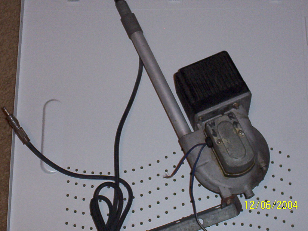

On my 1970 Z I had an aftermarket fixed-position antenna, the short (12" or so) flexible kind. Well it broke so I was going to put in a power antenna I bought a couple years back...it is supposed to be a used stock S30 power antenna.
Wouldn't you know that when I removed the interior quarter panel there was a power antenna just laying in there, still wired up even!! The only reason I didn't just reinstall it was that the nut and trim/grommet piece for the outside of the body seem to be missing.
Well having this in there gave me the opportunty to compare it to the one I had boght years previous. They are not identicle though similar and would like to know which if either (or both) is correct.
Here is a link to the pix of the two: http://www.pape.ws/allan_and_rosanne/Z-Car_Stuff/My%20Power%20Antenna/

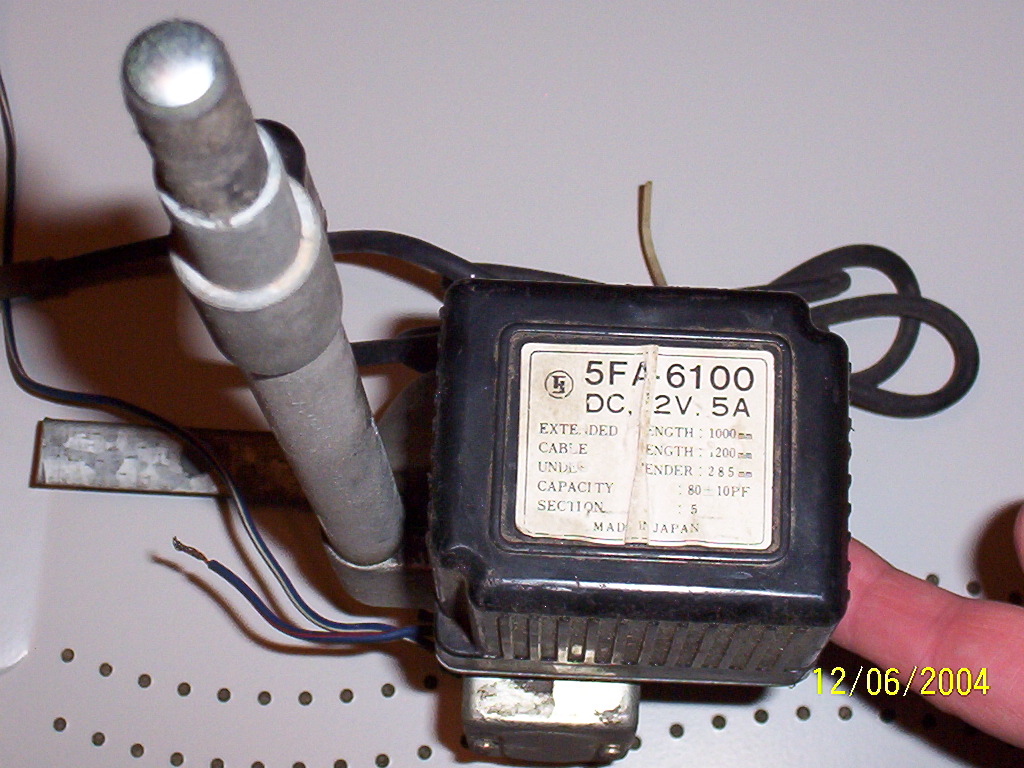

To expand on EScalon points: The old unit is an aftermarket Harada unit for a S30. The replacement you bought looks like it is for ZX because the trim/grommet size (smaller diameter) and antenna tip style.

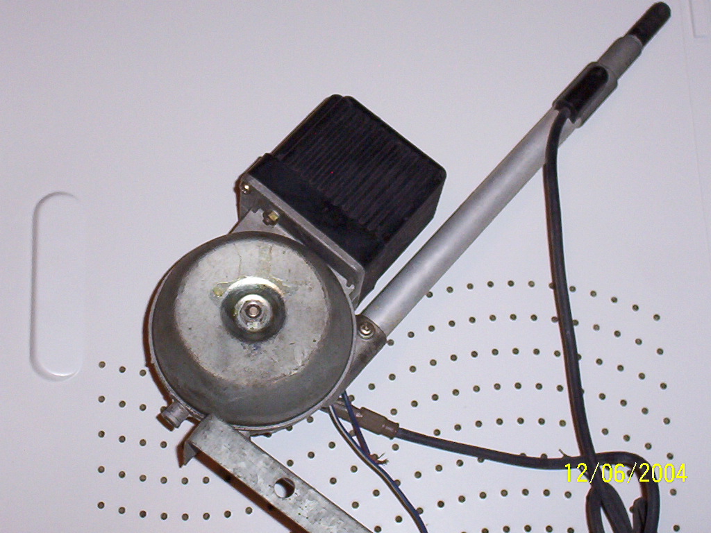

The Harada unit is a "plug and play" for the S30. The wiring is factory connections (bullet) and the antenna connection is a push-on. Unfortunately the Harada unit is missing the antenna and the motor may not be working.
You would have to adapt the wiring and antenna connection to use the ZX antenna.

Here are some pics of what I think is the Harada unit. Hope this can help.
