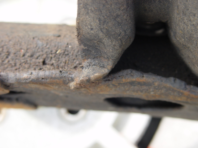

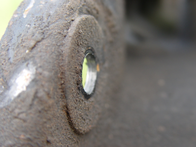

Well Terrapin Z is correct, he found the "kit" installed in my car... and indeed the mount has been cut out to 1 1/8".
At this point I am thinking the BEST way to handle this is to go back to a stock arrangement. I need to see the surface that the stock bushing rests against on the insides of the body-side mount.
I COULD weld the 1 1/8 hole shut and redrill for the stock bolt... but I think this would be easier and maybe better:
I'm thinking I could take the washer think, weld the hole closed and then drill the proper sized hole dead center. Use a stock bushing and a bolt of the proper shaft diameter that is long enough and torque down against the steel bushing sleeve that way. Centering the bolt on both sides rather than off center like the washer is now.
Thoughts?

Well I was thinking it would be faster to just weld up the cam'washer thing and use it to "fill" the big hole (drilling a recentered hole for the right bolt)... I might need a bolt that is a bit longer in that case.
Was/is the stock inside of the body side just smooth steel with a hole in it? Does the bushing ends just rest against it or is there something else there?
What allows the TA to move up/down at this end?

Stock configuration is just a hole in the crossmember, the arm and it's bushing just sit up there and the bolt holds it in place. The rubber of the stock bushing allows the arm to move up and down. That's it. plain and simple.
Nothing on the inside of the crossmember, no washers, spacers or anything like that. just the inner steel tube of the bushing, resting between the sidewalls, compressed into place when you tighten the bolt that runs through it.

The crossmember is not just a single formed "upsidedown U" shape. There is an additional steel plate for either reinforcing/proper spacing. I would replace the crossmember. Just my 2 cents.

Curtis240Z is correct in the fact that there are spot welded on washers on the inside of the cross brace. I also agree that you should replace the whole thing.

Well it's that washer diameter that was cut out of the brace to install this kit. The kit's washer thing sits in this 1 1/8" hole and provides a surface to torque the bushing against. I would even hazard to say that the kit's thick washer is a more solid surface to torque against...
That said I do agree that the RIGHT way is to replace the whole thing with a stock, unmolested piece... that's not going to happen here in round one... I do not feel there is a safety issue the way I'm doing it - I wouldn't do it if I felt otherwise.
