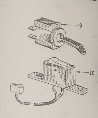

Here's some data from the Japanese Nissan Parts Catalogue ( Publication Number C-236 ) from 1972 which covers both the "early" and "late" types and references their changeover period.
The picture attached shows the drawing of the two types of Fog Lamp Switch.
Part no. 9 is the *25370-E4100 "SWITCH COMP. - fog lamp"
Part no. 10 is the *25370-E8700 "SWITCH COMP. - fog lamp"
Part no. 9 is the "early" type and no. 10 is the "late" type.
When the Japanese market got the chance to buy HS30 series L24-equipped cars ( October 1971 ) in addition to what they previously had, the factory changed over to the "later" type switch. This was apparently because the console changed, and the console changed because the "B" type transmission was phased in. All the Japanese Home-market HS30-series cars got the "B" type box from October 1971. The corresponding hole in the sheetmetal around the shift lever was different, thus the console design was changed.
Looks like the "early" switch was dash-mounted and the "late" switch was console mounted.

You've confirmed what I had deduced.
Since the "early" dashes, meaning the ones with the fuse / ashtray cover combination had the cigar lighter mounted through that cover, it didn't make sense for Datsun to have place a SECOND lighter in the dash. Even though some dashes apparently got drilled for that, it just looked odd. Why have a lighter on the dash, and another one less than 18" away on the fuse box cover?
The early console didn't have another opening other than the parking light switch hole for a fog lamp. This is probably why so many folks in the U.S. believe that the parking lamp switch opening is / was for a fog lamp switch.
When I was told that that opening was for the fog lamp, I wondered why there would be two instances of the word "ON" directly above the switch. As I investigated that, is how I discovered, with the help of this site and another site and of course, you, that that was for the parking light switch.
I've not yet run into an early fog lamp switch, although now that I look at the "later" style, I may have seen one in a boneyard and dismissed it (darn!).
Ok, at least the early switch can be "fabricated", meaning that there are various toggle switches that match the basic look of the switch.
Do you have any idea if the switch was illuminated? From the fact that the switch in the picture only has 2 terminals I would tend to doubt it, but stranger things have happened yet.
Also, do you know what symbol it had engraved on the handle? The hazard switch has what appears to be a double triangle, one inside the other, so it stands to reason that the fog lamp switch would also have a symbol on the handle.
Thank you again Alan, this has been extremely helpful. Now I can go out and see what I can do to manufacture, fabricate, or otherwise modify switches that I can find in order to at least have the correct appearance even though they won't be OEM parts.

Glad that helped a little. Regarding your further questions; I think you are right that neither of the switches was illuminated. Looking at the wiring ( although its hard to tell from Nissan's sketch ) it just doesn't seem that they can be, and the only illuminated switch I know of on early S30-series Z cars was the rear window de-mister switch ( which was probably illuminated as a reminder to turn it OFF as much as anything else! ).
I should imagine that the toggle type ( "later" ) switch was pretty much generic in the Nissan lineup, and it looks very similar to the type of switches that I have seen in the C10 series Skylines that were contemporary to the S30-series Z.
