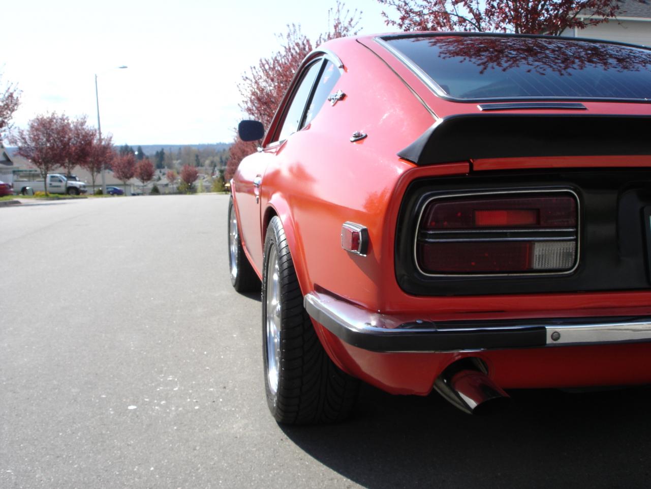

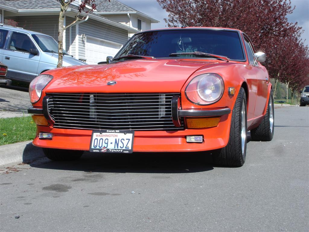

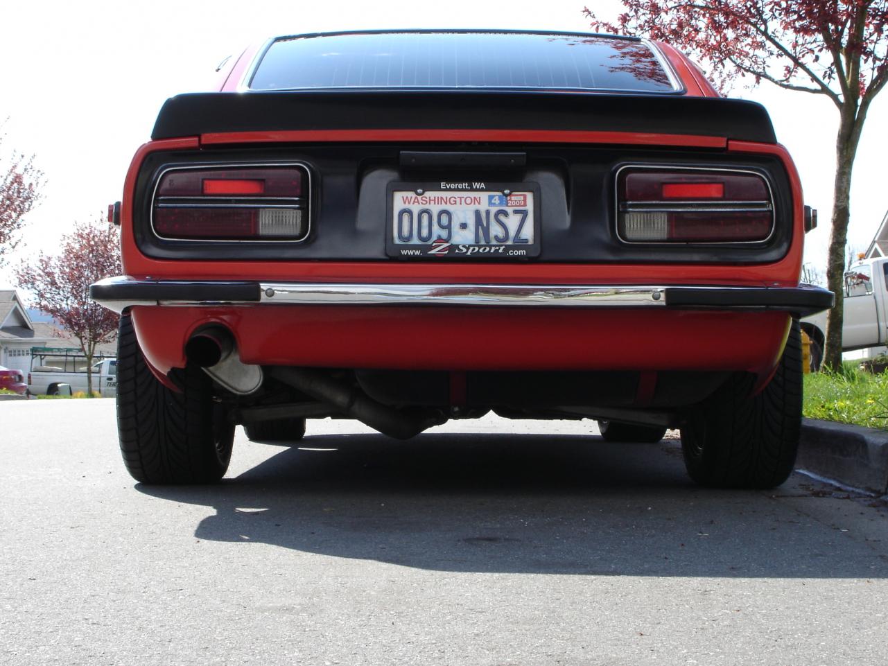

I have Eibachs and KYB's (soon to be Tokico HP's) 225/50ZR16's And there's no rubbing, great grip, smooth ride and they fill the well without any issues.
Dave
Pics below show how they look, plenty of clearance without looking too small.
