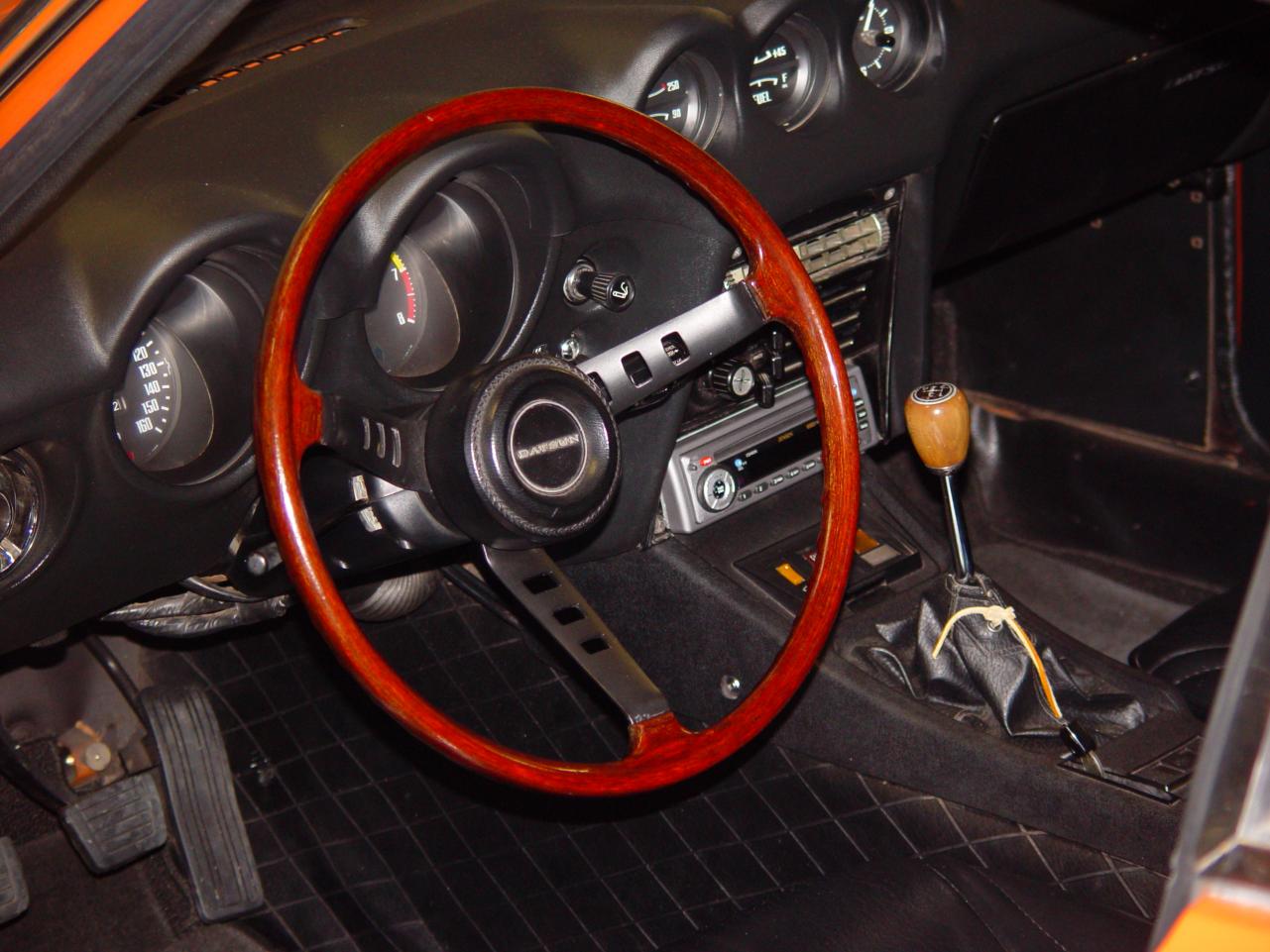

FWIW, I didn't stain mine at all. I did this 6 years ago, and used no funky stains or oils or anything. I started out with a Scotch Brite to take all the buildup of 31 years of driver's hands off, then sanded it a bit. Afterwards, I masked the spokes and sprayed some urethane clear coat over the rim, and it turned out great.
It looks very red in this picture, but it's a much darker color in person. The flash really changes the appearance of colors sometimes.
