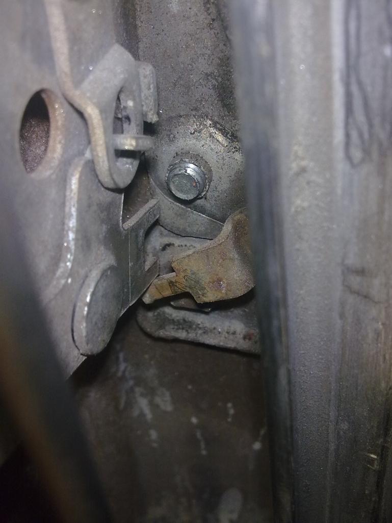

Still no improvement on pass side door. More problems in drivers side. I noticed that the pushrod (that connects lock cylinder to the rest) is not in the right place. Should that lever be in that hole? I tried to move it back to place but failed..
Yes, it needs to be in that hole. In a worst case scenario, you could try getting another door mechanism from Zbarn. I just bought one from Roger a couple of weeks ago.

Something to try... Did you remove / reinstall the assembly? If so, here's what fixed the same problem for me.
I found that the position of the interior door latch, (that handle that opens the door), can affect the operation of the door locks. If you loosen the screws holding this assembly, (inside botoom of door), it's position can be adjusted. If the assembly is too far forward, on the attached rod can't move back far enough and prevents the door lock from operating.
When I moved my latch handle assembly back about 5/16", everything worked fine.

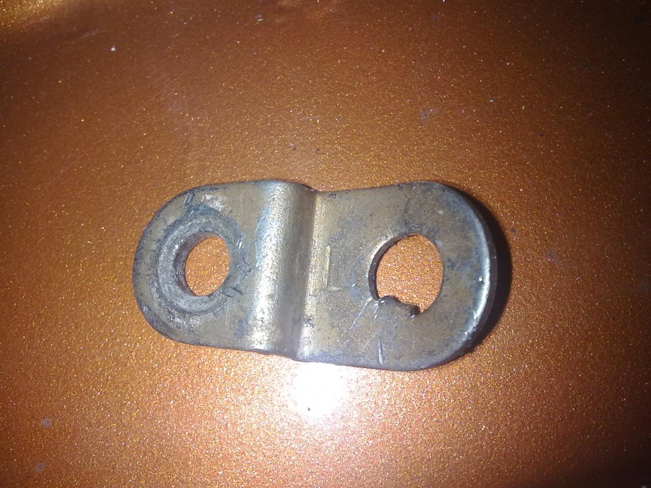

I got that lever on place on drivers side door. Well after that i discovered next problem. This part (on pic) is worn out and it wont move pushrod enough to lock the door from outside.
Also, im afraid to take out the passenger side window for lock removal, it fits so good now :cry:
That piece does not look worn.
Are you sure it isn't the end of the lock cylinder that it attaches to that is the worn item?
The lock cylinder metal is a "pot" metal and not as strong as the stamped steel piece in your picture, and it's more commonly the one that gets worn down.
