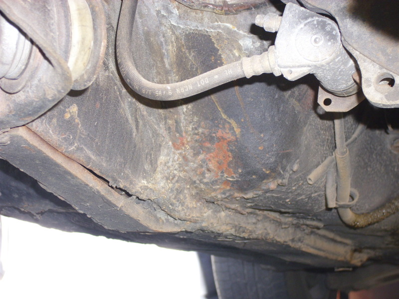

One thing I noticed going back through the pictures is the passenger side frame rail - it looks different from the driver side. Anyone know what that's about?
Oh, and the VIN is HLS30-69150
Just a guess, but it appears the car was rear ended at some point in its life. That's what the gap between the rear finisher and the rear valance, plus the signs of body filler, seem to indicate. Get a flashlight and look up into the space between the rear valance and the gas tank. Take a look at the brace up there and see if it shows signs of a rear impact. Also check if the gas tank itself shows signs of damage. Not necessarily a show stopper, as these things can be fixed or replaced.
I didn't look at all the pictures, but the shot of the roof looks like it may have a little bit of hail damage.
^ that's what I was asking about with reference to the two rails looking different. What does that look like to you? I didn't notice it until I was uploading the pictures after I'd returned from looking at the car.
Looks to me like the original was very rusted out so someone partially welded bar stock in there. For what it's worth, I consider it one of the most important parts of the car. It is a structural member or a box beam component. I will see If I can find a picture a what a good one should look like.
