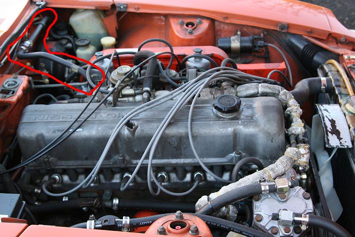

OK,
After owning 5 240Z's I should know this.....but sadly I don't.
What exactly is the part pictured (circled in red) called. I couldn't find it on several parts catelogs so I thought one of you guys could help me out.
Thanks,
Randy
PS....Generic picture from a 73, but assume it will be the same for a 70.
The part in the picture is the vacumn hoses and check valve for the brake master cylinder. Don't know if they are still available from Nissan but you could try Courtesy Nissan.
Jeff
I believe the check valve is still available, but to the best of my knowledge, the two hoses are NLA. There are more than one style, definitely early and late, might be an intermediate choice as well.
Various people have built replica hoses using cloth covered normal hose, and running copper wire inside to hold the proper bends. I'm a bit leery of that myself, the original hoses were heavily reinforced to prevent them from collapsing under high vacuum conditions, which could cause a reduction in power assist for the brakes.
Jeff and Arne,
Thanks for the clarification on the valve and hoses.
I did find the check valve, and just as you said struck out on the hoses. However there is one set on EBay right now but it still has 4 or 5 days left.
Since I'm not looking to do a concours restoration, is it safe and effective to use a hose from an auto parts store? If so what grade and size.
Thanks guys, hopefully one day before I'm 80 I'll get this car running.....

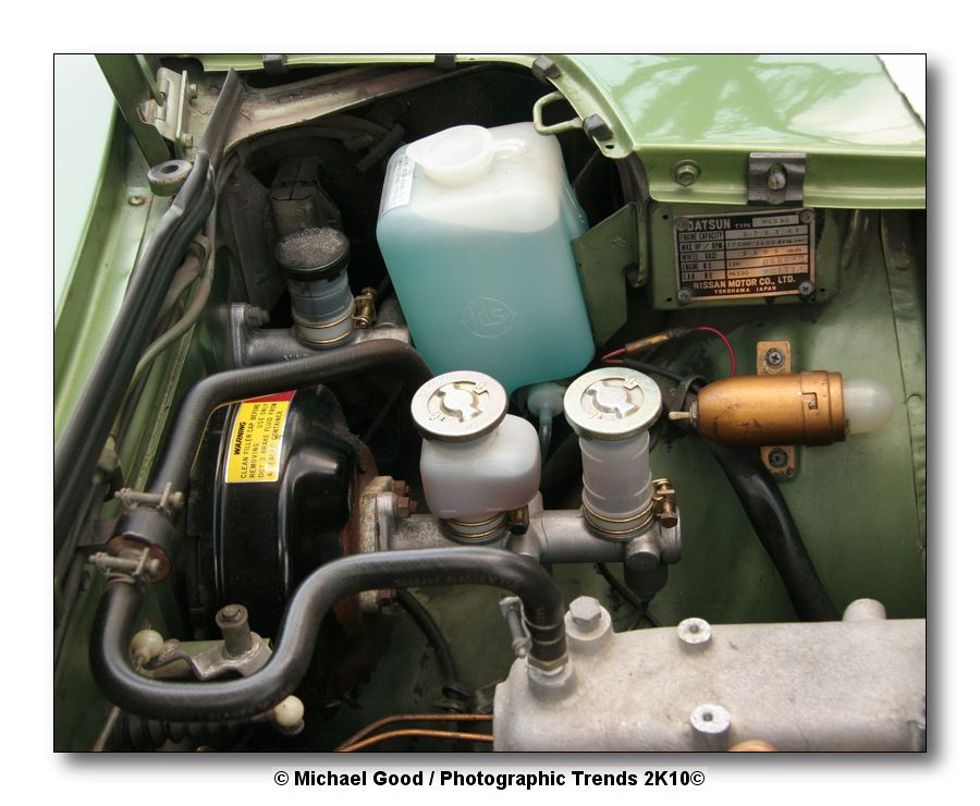

Here it is on my 76 - 280, looks like a different hose.
Generally, the hoses don't wear out. The vacuum check valves can get gummy. When I was looking for the parts for my Z, I found that the vacuum valves that Nissan used were the same across several models. I replaced mine with one from a Sentra. Some of the vacuum check valves have a rubber spacer donut that can be removed - then it will fit perfectly on a Z.
