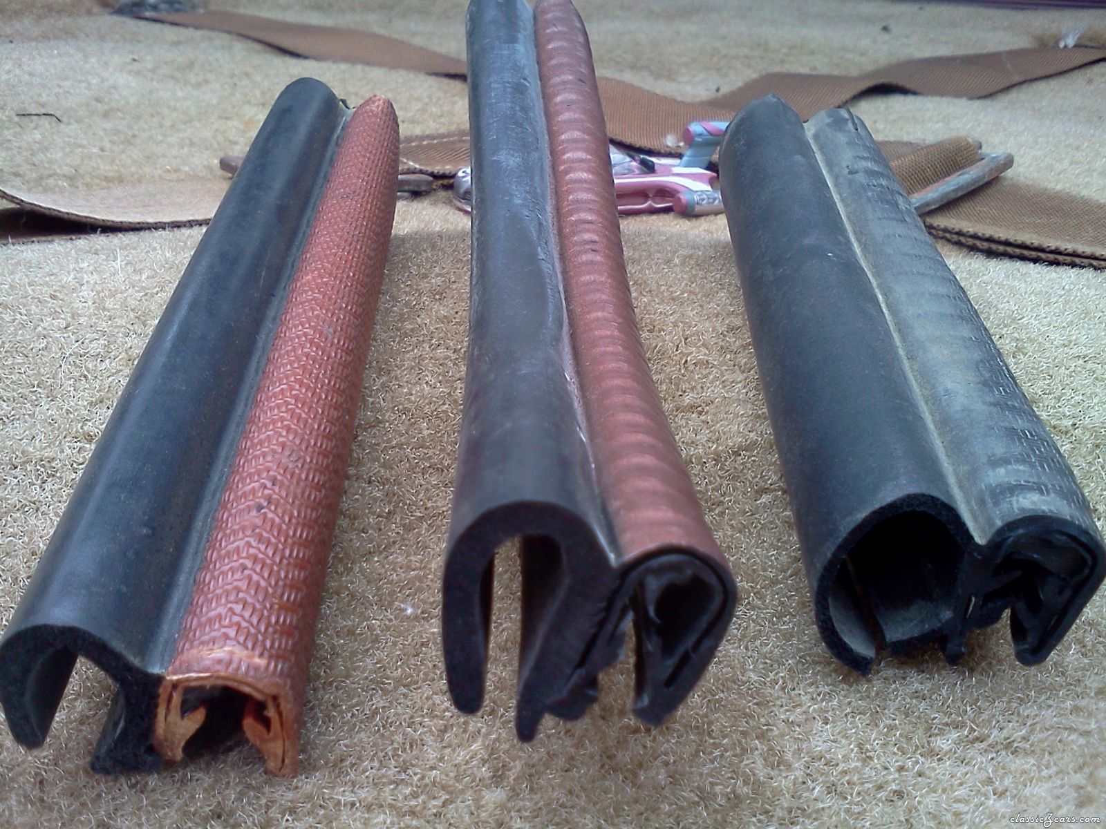

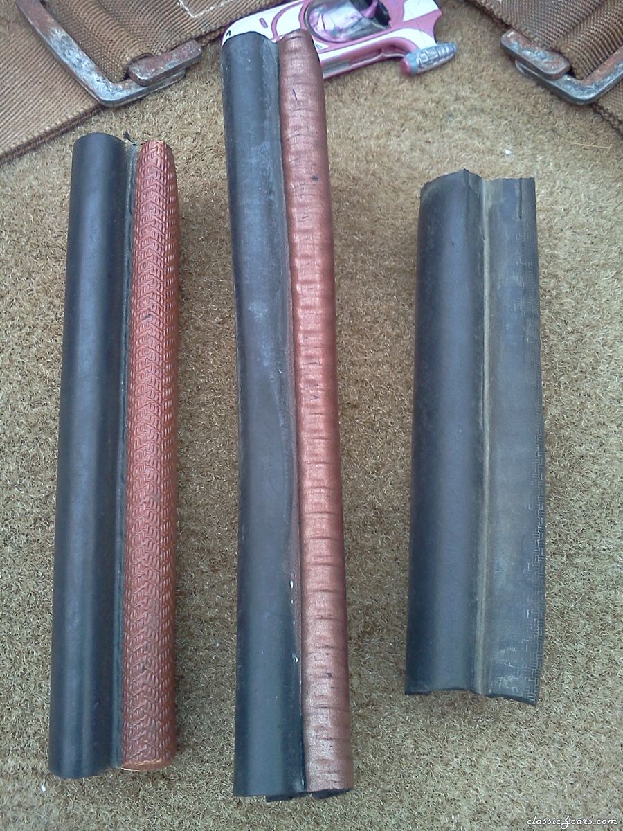

March 21, 201510 yr comment_466128 For the princely sum of $5 I got 9 pieces of Kia weatherstripping. I found that the rear passenger Sportage door seals work on the Z driver and passenger doors, and the front Sportage seal works on the Z hatch, having a few inches left over in both cases. The doors and hatch all close nicely with a good seal 'crush' all around. Hoping this is a good first step in eliminating some fumes...After being picky and discarding a couple pieces I shouldn't have bothered with, I have enough to redo the car when I need to. Fun cheap project, thank you to all for showing the way.  From left, Original Driver Side, Ten Year Old Black Dragon Replacement, and Kia Sportage. When I replaced the passenger side years ago I was also painting a fender, so I scuffed and shot the inside bead to kinda match the original piece. It held up well, was never noticed, or mentioned, so eventually I'll find a better color and do the same to the Kia stuff when I repaint the car. Link to comment https://www.classiczcars.com/forums/topic/34633-kia-sportage-weatherstip-rocks/?&page=11#findComment-466128 Share on other sites More sharing options...

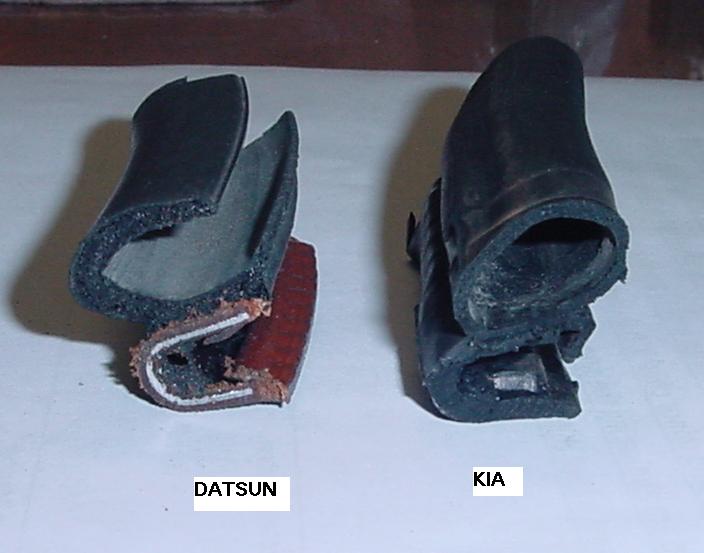

March 29, 201510 yr comment_466689 I got a photo of the original and Kia weatherstripping too. maybe someone could explain why the Datsun door seal is split and not tubular?  I haven't tried it yet, but it looks like it should be interesting to get the Kia one to fit into the hatch frame. Would someone please get a close-up photo of a bit of the Kia seal on the hatch frame? Edited March 29, 201510 yr by TomoHawk Link to comment https://www.classiczcars.com/forums/topic/34633-kia-sportage-weatherstip-rocks/?&page=11#findComment-466689 Share on other sites More sharing options...
