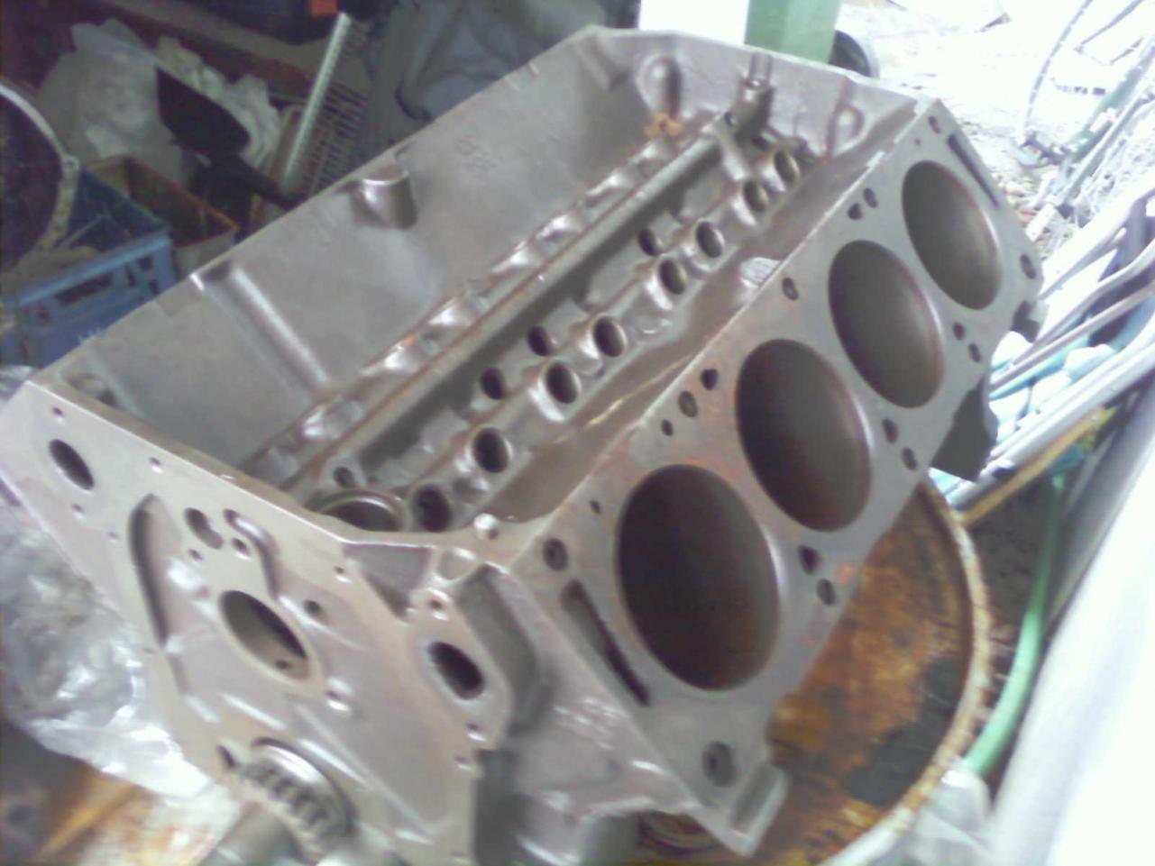

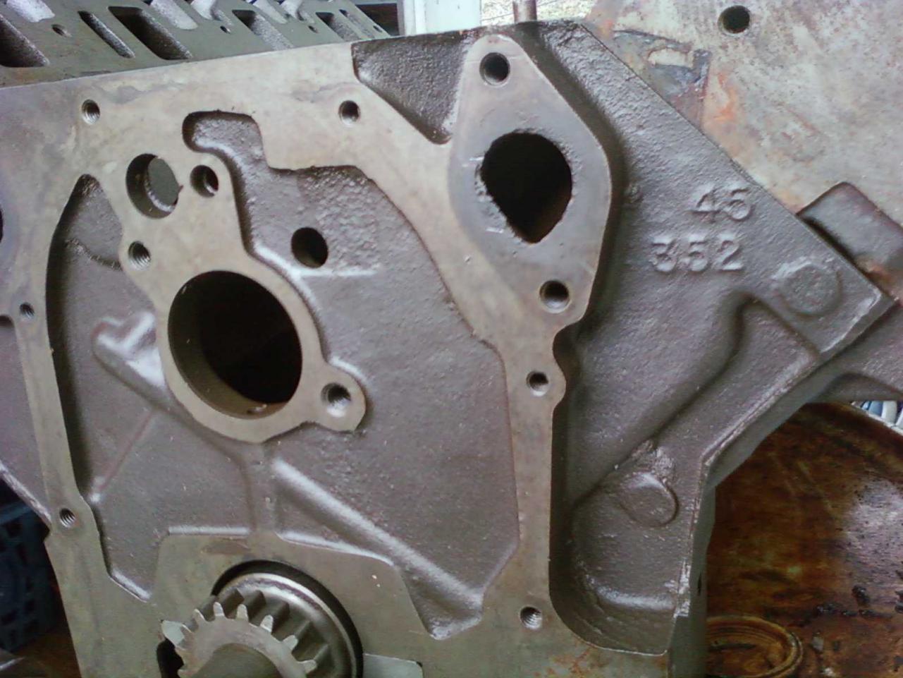

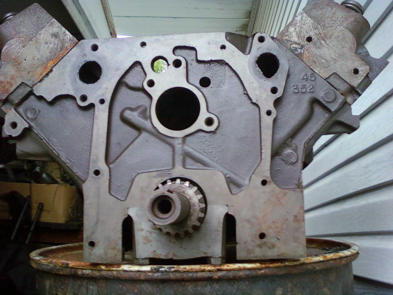

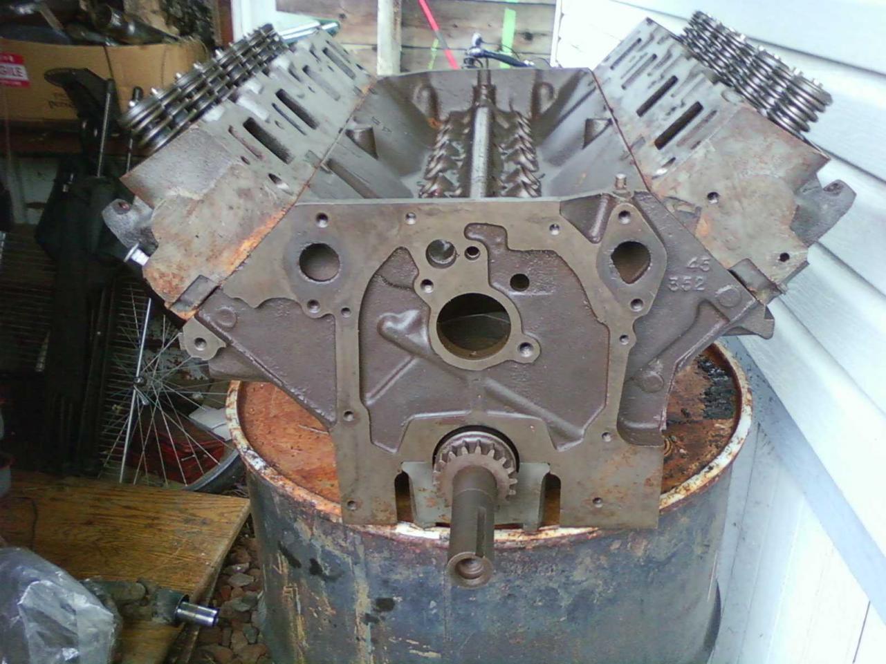

i just got my manual trans and r200 diff all set. car runs great.
i kept the car for the sole purpose of putting a v8 in it. i wanted to put a lt1 or ls1. but i got this block and set of heads last night for free.
from what ive read on the internet its a 390. it has a 3U crank with a bore of 4.05. the heads are factory ford D2TEAA.
the block is empty. just has a crank shaft. its setup for hydraulic lifters.
not sure if this would be a good one to use for the z or not? it has the 4 bolt holes for the motor mount.
any input would be greatly appreciated...
also will the r200 diff hold a v8?
might talk to the folks over at hybrid z.. 390 fully dressed is awfully wide from what I can remember, and you may end up doing a lot of the fab work yourself for mounts, etc..
Oh, and the differential will most likely hold up if it's in good shape..
A better idea, if you are a Ford guy, would be a 302-based 347 stroker,
which you can get as a crate motor. The nice thing about the small
block Fords, even compared to SBC, is that the block is so little it can
fit practically anywhere. A guy in the next town has a 302 Mustang
engine in a '71 PL521 Datsun pickup which is a nice conversion. I was
thinking of doing the same thing in our '71 510 2-door.
FWIW, ~Rick~
Realistically speaking, FREE is not a very sound decision making basis, especially when it's a non main stream big ol honkin' block..... ;)
You will spend a lot more money buying parts for the 390 and custom fabricating mounts and such for an unusual swap than you will in buying a basic Chevy SB and the already proven and engineered parts to install it. Your "free" 390 will be a lot more expensive in the end.
