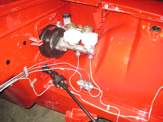

I need peoples opinions on something. I have the old hard lines from the brakes and fuel lines and they are in pretty good shape for their age. There is still some of the cadmium plating on them. The question is....do I have them replated and use them again or do I just replace them with newer stainless steel lines. I am not going for a concourse rebuild so its not like I need them to be original. Part of me would like to reuse them because of the good condition. Do the newer stainless steel lines get you anything? I know when the rubber lines are replaced with flexible stainless lines you get better response. Also, the cost to replate them may be a factor as well. Any input is always appreciated.

Carl,
I was in the same dilemma. Though my lines were very servicable, I didn't want to put in nasty looking hard lines against a freshly painted engine compartment. I also have put on wildwoods and needed to install a bias valve, so my lines would have looked different from each other. I opted for new lines that I orderd off of ebay-not SS, just newer ones. The line kits were cheap and the fitting were correct for our cars. The lines were also very maliable and most of my bends were done by hand. I think they were about 50$
The fuel lines I did just paint with some por-15 silver. They didn't look "concourse" by any means, but they looked fresh and consistant in color.
As far as whether you would mechanically benefit from SS lines, I can not see where that would make a difference.
When I was working on the brakes of my Z, I went with the old hardlines, but I did choose new hoses to the Calipers and Drums. I also went with Loaded Calipers and New Cylinders/Hardware for the rear.
I cleaned my lines by soaking them in Varsol for a few days to dissolve the undercoating and loosen the crap that was inside the lines. I used a snug piece of lawn trimmer line to chase the inside of the lines to remove any debris. Finally, flushing the lines with spray brake cleaner prior to installation.
I don't think that there is anything wrong with using new hardlines if you have the time and inclination to do the bending. (I probably would have about the same amount of time invested if I had used the new lines though). I would suggest that you should ALWAYS replace the hoses to the Calipers and Drums. SS Braided lines always look nice on a car -they perform better and last longer.
With all of that said, I think that you should give it a shot. Build a JIG to lay out the lines, use a good tube bending tool and take your time! Brakes are the most important part of your car! This is where you should definately put your $$$! Generally, brake parts are all pretty reasonable(conversions aside) - so don't scrimp.:classic:
Thanks Steve and Andrew,
I appreciate the advice. If I'm going to all the trouble of rebuilding the car, I might as well put new lines on. I will keep the old lines so I know how to bend them.
carl
