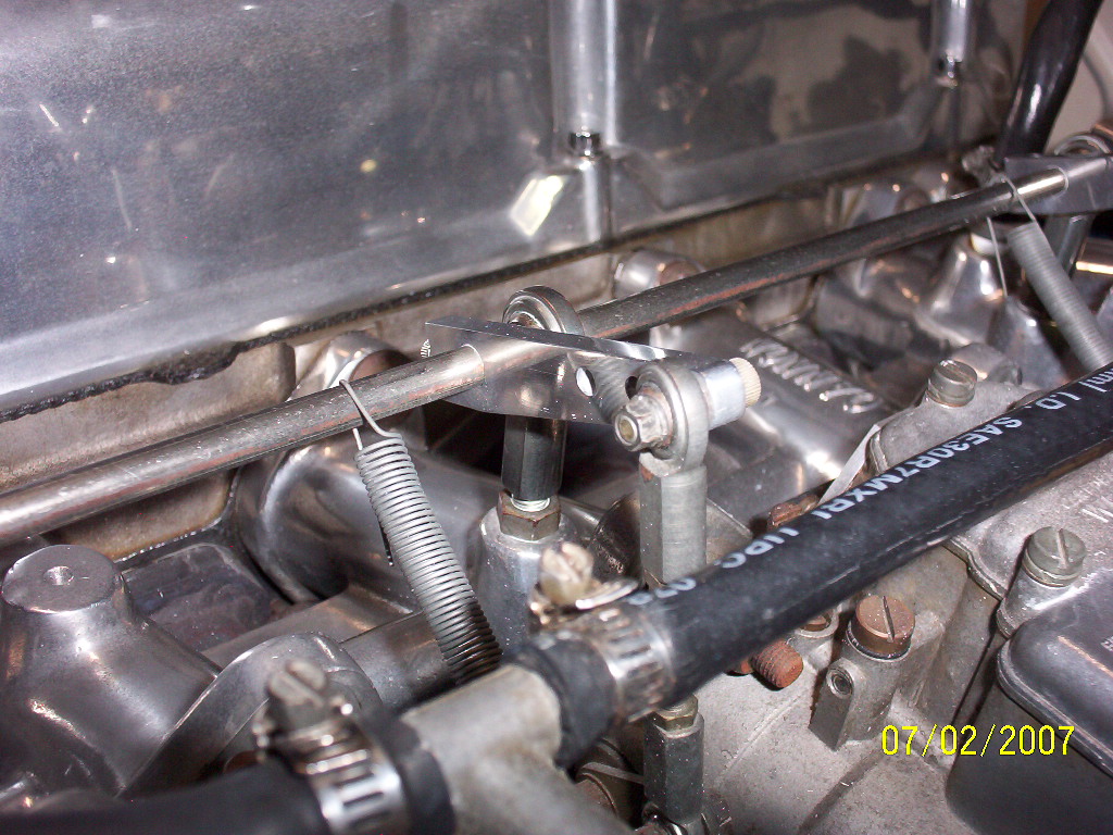

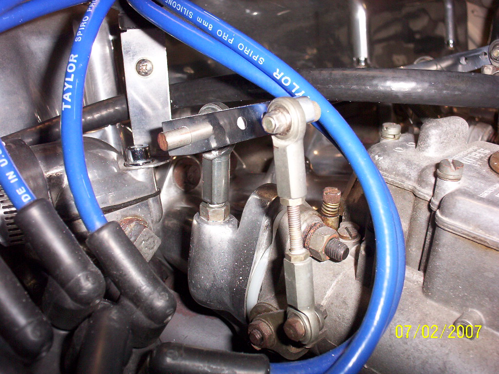

Here are some pics of the triple linkage I fabricated. Maybe you can use some ideas.
Nice, did you machine the levers or were those bought? Do they use a set screw? Does it thread into the rod or is there a clamp I didn't notice? I like the heim style rod ends, they are solid and precise.
