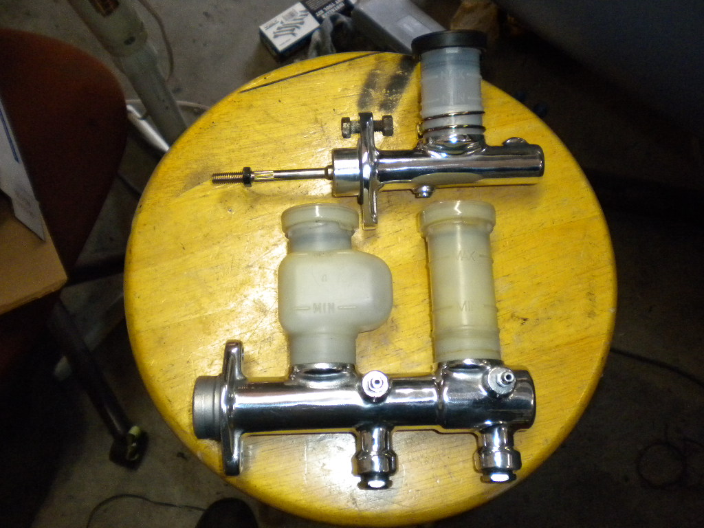

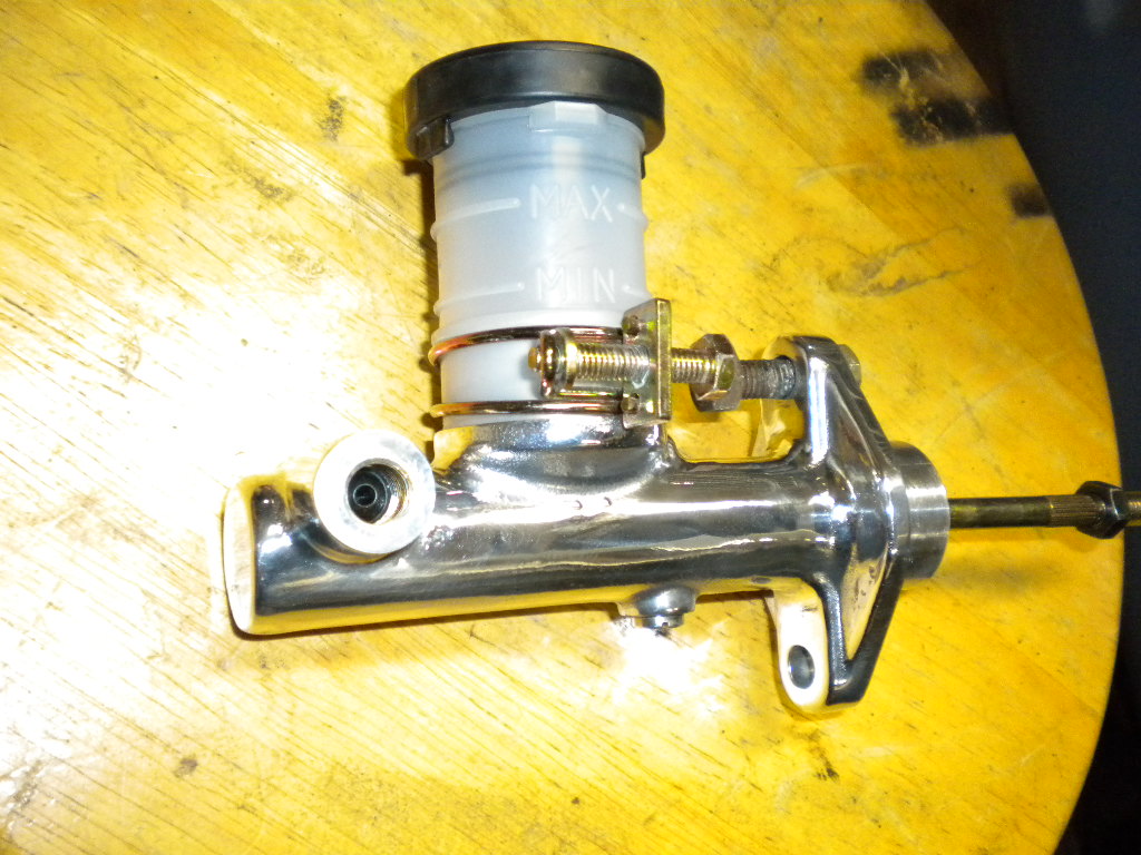

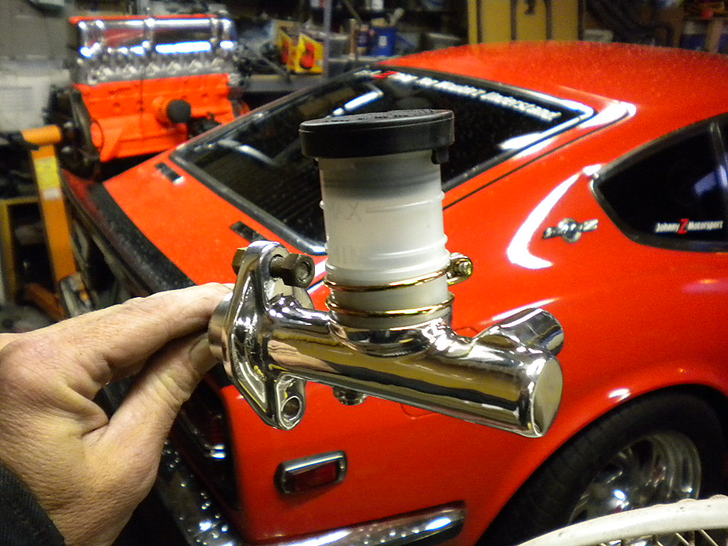

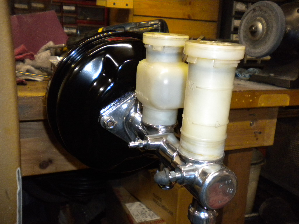

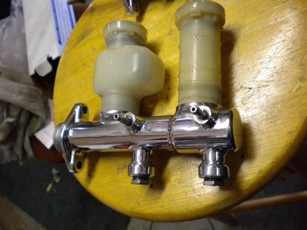

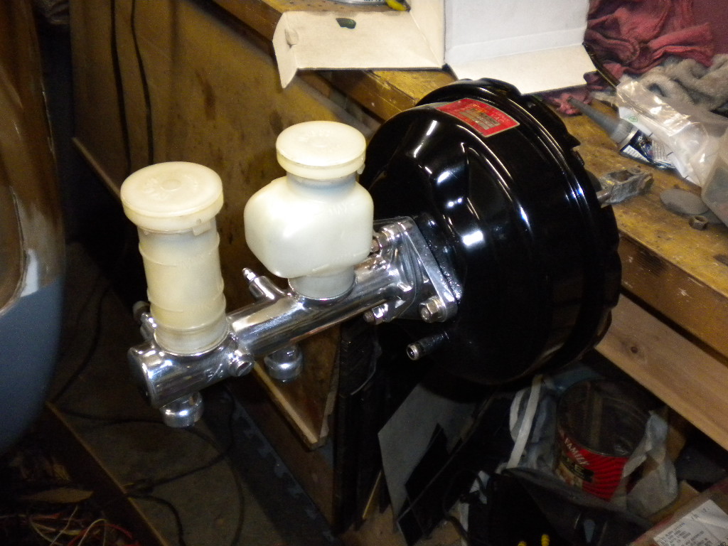

Speaking of masters, I got my 15/16" ZX master cylinder today (for the 260Z's big brake set-up. And took it right to the buffer after sanding it down. I also sandblasted the Vac Booster and painted it.
Dave.
