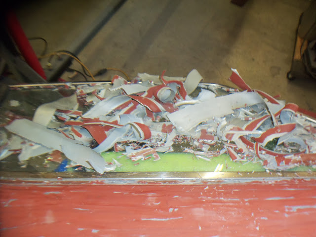

All I have left to do before putting high-build primer in the 240Z is the doors. There's so much paint on them they need to be stripped and being large and flat I decided to use the heat gun and scraper.
The left door was a replacement and had been painted several times, several different colors...
The right door was painted twice, silver each time:
A quick run with 80 on the DA and the should be ready for primer too! :)
