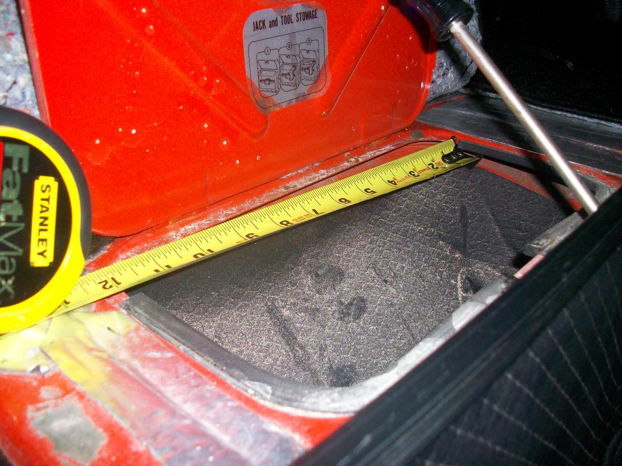

So can I ask you a favor? I can't really measure/examine mine without pulling out my hatch floor. Perhaps you could eyeball the compartments for me? Do they look large enough that I could drop the magnet of maybe a 10" subwoofer through them, if the mounting surface is maybe 3" above the metal deck? Perhaps just an 8" sub? If this is within the real of possibility, then I might start disassembling the thing to see how I can do it. Unfortunately it's not as easy as simply pulling back the carpet and detaching the false floor. My car is a bit more involved than that, owing to the stereo installation.
Here Fastwoman, take a look at these pictures, they may help you with sizing.

Thanks, 260zCaliCar! That helps me a lot. (The compartments are smaller than I had remembered.) If I might ask for another favor, what is the distance from the rear-most edge of the compartment to the sloping bottom below, measured perpendicularly to the deck? I'm wondering how far down I can drop a speaker magnet.

The compartment is shaped like a right angle triangle with the 90 degree angle just behind the seat. The depth is 9 inches, and the opening is about 5.5 inches.
This should allow you to interpolate the width at any given depth within the space.

Ah, now I get it. OK, I wasn't seeing your photo the right way. There was a shadow there that was throwing me off. That's going to be a tricky space to use for a subwoofer magnet! I'll have to think about that. Anyway, I appreciate the photo and the measurements. Now I know what I'm dealing with. :)
