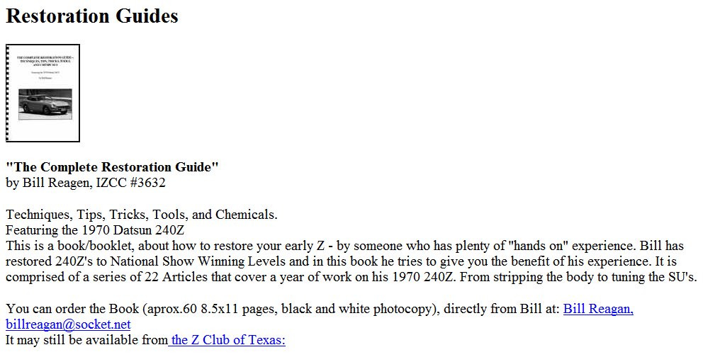

Bill Reagen’s booklet is worth having, if you can find a copy:
I agree, Bills book is great-it is a collection of articles he wrote for the Texas Z Club. There are some things that need to be added since it was written, but it is still chock full of great stuff!
It took me more than six months to track one down. I have been in touch with Bill about updating and making it available again...
Will
You should still be able to get them from Z Club of Texas. Contact them at zcotboutique@aol.com. I got one about a year and a half ago for $10 plus $4.60 shipping.
