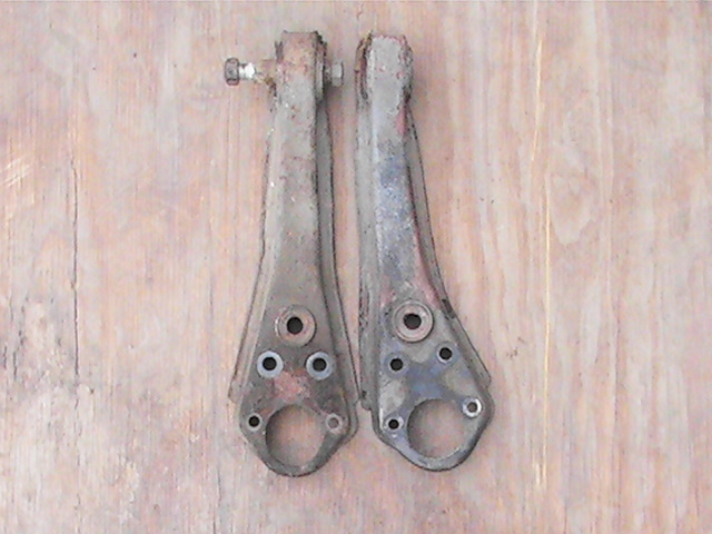

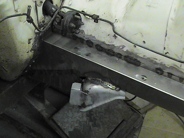

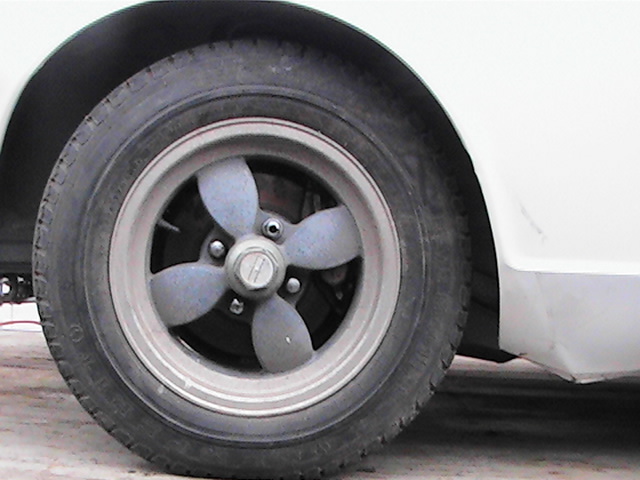

Folks may remember that I crashed my '72 last fall and bent the left front frame rail (see photos). Over the winter, we replaced that frame rail with a new one from Zedd Findings. There was a bunch of other work done too: new paint, exhaust upgrade, refurbish the entire suspension (with camber bushings in the front), etc. The car was on the road for the first time this year yesterday and that was to head to the alignment bay at NTB.
Fortunately, the technician who did the work is a local SCCA autocrosser (Honda Civic Si) so we hit it off quite well, he took his time and involved me in making decisions. Once he did the best he could, we ran across a problem in the caster values. The right side unloaded value is 2.9 degrees (factory spec is 2.92 ± 0.50) but the left was only 1.3 degrees. I had noticed a pull to the left when driving to the shop, but because the toe and camber were just guesstimates from when I reassembled the front end, I couldn’t be sure of the cause. We went for a short hop on I-71 and still felt the leftward pull, which the technician called "caster steer". Obviously, even though we measured a number of times, we didn't get the T/C bracket installed exactly equivalent to the right side location.:stupid:
