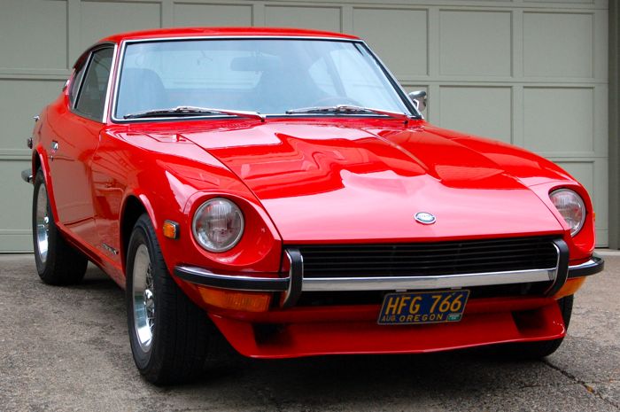

May 21, 200916 yr comment_284309 I like, Stephen. Still not sold on the clear side markers, but the rest of it is good. No, I won't say "groovy". Link to comment https://www.classiczcars.com/forums/topic/30667-front-end-spook-options/?&page=13#findComment-284309 Share on other sites More sharing options...
May 21, 200916 yr comment_284322 You are doing a great job and we can see how good it is going to look. I realize you are not done with it yet and I don't mean to sound critical, but I think it is going to be nessesary to use some plate/spreader washers and drill more holes in order to add additional bolts, to clamp the spook evenly to the valance panel, thus eliminating any gaps. In order to be effective the plate washers should be used in pairs, both on either side of the valance & spook. If there still is a gap showing you could always use a rubber welting strip where the spooks meets the valance. This is just what I see from your pics, but you would know better what it will take to close up the gaps. Link to comment https://www.classiczcars.com/forums/topic/30667-front-end-spook-options/?&page=13#findComment-284322 Share on other sites More sharing options...
May 21, 200916 yr comment_284325 looking good. I didn't think I would like the spoiler color matched but looks very nice in silver!!! Link to comment https://www.classiczcars.com/forums/topic/30667-front-end-spook-options/?&page=13#findComment-284325 Share on other sites More sharing options...
May 21, 200916 yr comment_284326 looking good. I didn't think I would like the spoiler color matched but looks very nice in silver!!!I like them both color-matched or contrasting. IMO, the ducted versions with the complex curves around the ducts are especially nice in color. Link to comment https://www.classiczcars.com/forums/topic/30667-front-end-spook-options/?&page=13#findComment-284326 Share on other sites More sharing options...
May 21, 200916 yr Author comment_284329 You are doing a great job and we can see how good it is going to look. I realize you are not done with it yet and I don't mean to sound critical, but I think it is going to be nessesary to use some plate/spreader washers and drill more holes in order to add additional bolts, to clamp the spook evenly to the valance panel, thus eliminating any gaps. In order to be effective the plate washers should be used in pairs, both on either side of the valance & spook. If there still is a gap showing you could always use a rubber welting strip where the spooks meets the valance. This is just what I see from your pics, but you would know better what it will take to close up the gaps.Geezer, you always have enlightened opinions, and I have Saturday reserved for fixing those gaps. I think your right on needing more support. The spoiler is very rigid right now when the bolts are tightened. But I agree it needs to be worked on a tad.I am using 1.25" spreader washers now, but I bought 5 more bolts and washers just in case this happened. I will start this fabricating process Saturday. I only used the 5 captive nuts that came from Datsun in my lower valance. I think it needs probably 2 more to close up the gaps. Link to comment https://www.classiczcars.com/forums/topic/30667-front-end-spook-options/?&page=13#findComment-284329 Share on other sites More sharing options...
May 21, 200916 yr Author comment_284335 I like, Stephen. Still not sold on the clear side markers, but the rest of it is good.No, I won't say "groovy". do you mean the side markers on the fender Arne, or the ones under the bumper? how about a 'crazy man'? Just check'n Link to comment https://www.classiczcars.com/forums/topic/30667-front-end-spook-options/?&page=13#findComment-284335 Share on other sites More sharing options...
May 21, 200916 yr comment_284340 I don't mind the clear turn signals under the bumper, but can't get into the side markers on the fenders that way. They just bum me out, dude... Link to comment https://www.classiczcars.com/forums/topic/30667-front-end-spook-options/?&page=13#findComment-284340 Share on other sites More sharing options...
May 21, 200916 yr comment_284343 But I agree it needs to be worked on a tad. I think it needs probably 2 more to close up the gaps. A beautiful Z such as yours is well worth taking the extra time and effort to "sweat the details". It is a good idea to slightly elongate the mounting holes to allow the spook to "find itself", when being fastened, remembering to tighten in a sequence from the center of the valance, working outward as mentioned earlier. When I finally mount mine, I will be able to review this thread and see a couple of very nice examples. Mine is one from MSA though. Link to comment https://www.classiczcars.com/forums/topic/30667-front-end-spook-options/?&page=13#findComment-284343 Share on other sites More sharing options...
May 21, 200916 yr comment_284349 Man your car is "far out", the spoiler looks "spunky", the indicators are "wild" ands you must be some "cool cat" driving down the road in those "wheels". Link to comment https://www.classiczcars.com/forums/topic/30667-front-end-spook-options/?&page=13#findComment-284349 Share on other sites More sharing options...
May 21, 200916 yr comment_284356 A beautiful Z such as yours is well worth taking the extra time and effort to "sweat the details". It is a good idea to slightly elongate the mounting holes to allow the spook to "find itself", when being fastened, remembering to tighten in a sequence from the center of the valance, working outward as mentioned earlier. When I finally mount mine, I will be able to review this thread and see a couple of very nice examples. Mine is one from MSA though.I did slot many of the holes on mine to assist in mounting stress free. Link to comment https://www.classiczcars.com/forums/topic/30667-front-end-spook-options/?&page=13#findComment-284356 Share on other sites More sharing options...
May 21, 200916 yr Author comment_284373 Geezer, mine is an MSA as well.RP975, I cant compete with you... Link to comment https://www.classiczcars.com/forums/topic/30667-front-end-spook-options/?&page=13#findComment-284373 Share on other sites More sharing options...
May 21, 200916 yr Author comment_284375 I don't mind the clear turn signals under the bumper, but can't get into the side markers on the fenders that way. They just bum me out, dude...Tell you what, I have a full set of side indicators, I will swap them out and we can compare. I do think they get lost on the silver Link to comment https://www.classiczcars.com/forums/topic/30667-front-end-spook-options/?&page=13#findComment-284375 Share on other sites More sharing options...
